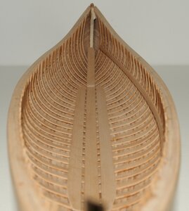

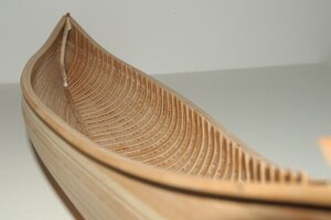

Installation of the ribs: one side at a time
Ribs are all in as well as some flooring and side strip:
A view of the gunwales and canoe sides (just for fun)...
At this point the inner gunwales are being installed (the glue is drying)....

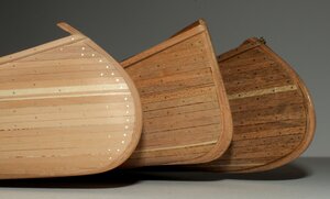

After a total of over 8 hours, the nails have inserted into one side of the canoe.
Here is a photo for fun...
The 17 " pear wood canoe is on the left: obviously still under construction.
The 17" cheery wood in the center. It has been varnish inside and out bu is missing seats and other parts
The 19" cherry wood also varnish and fitted (completed).
Quite a difference...

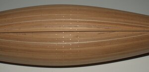

Update ....
The canoe as of September 2
Nailing is complete throughout the outside of the hull.

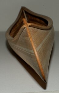

The keel has been installed: an extension of the outer-stem and running through the length of the canoe's underside.
Front view of the fastening on the outer stem.
The gunwale needing some shaping has been looked after since the photo was taken.
The inside of the hull has received its first coat of varnish prior to the installation of the decks, which will be done in the next couple of days.

Update ....
G
I like the double light accent strips with their variation in width. That stands out well from the rest of the upper hull and the subtle lower, waterline? strip. Nails on the stems are a new twist that you have brought forth . Great work as always on your precise part. PT-2

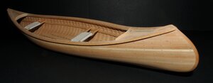

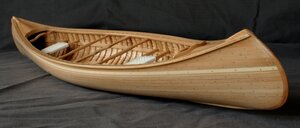

And an overall view with bow and stern seats dry-fitted.
Almost ready for the application of varnish on the outside...
G.
The upper accent strip stands out well with your wood combination. On my own with cherry and basswood it is very subtle and not distinctive as yours which is not what I was anticipating. Your decks with trims and seats look nice. PT-2

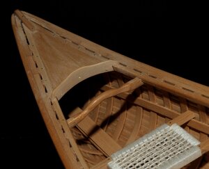

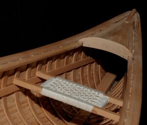

As represented, a canoe such as this one is likely to be on the heavy side to be carried by an average person on his / her own, so I have decided to include a carrying handle on each side in situations where two people would move the canoe.: quite often, the people carrying the canoe use the deck to hold it and that is what I did on my wood strip canoe. Anyways, it adds another element to the overall look. These "handles" can also serve as thwarts to stiffen the hull: although, considering the size of the decks and other features, this cane would hardly need any stiffening.
So here is one of the "handles", carved in a combination of cherry and pear wood.
The inside of the canoe has been varnished (2 coats) up to but not including the inner gunwale. I am debating whether to apply another coat so permanent installation of the seat will wait.
I still need to make the yoke and maybe a thwart (as the subject came up in another thread a while back).
G.

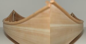

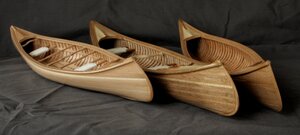

This 17-inch Canoe model is basically complete: with 8 thin coats of varnish applied on the outside.
The paddles will be made in the days to come.
And here is a photo of the 3 canoes I have been working on since the beginning of this group build.
from Left to right:
- 17-inch pear wood
- 19-inch cherry
- 17-inch cherry (this one still needs a few more details to call it complete).
G.
