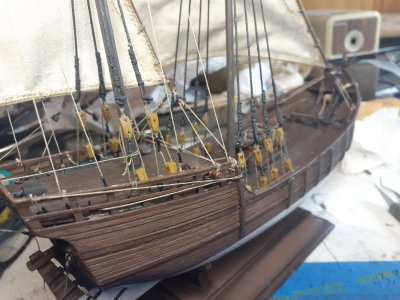

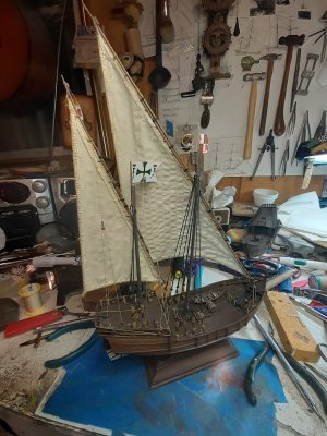

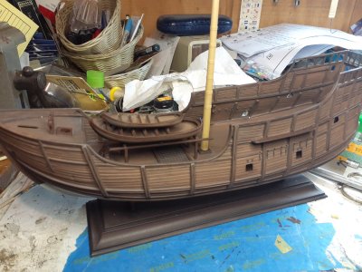

Hoy, I'm back, sorry for the delay. Please know I am not telling you how to do ANYTHING. This is how I painted the 1/75 Heller Columbus ships and I'm happy with the results, mind you, I'm not entering any contests.
These are the paints and colors I used above the waterline. I airbrushed the Hull, Bulwarks and Decks with 'Real Colors' Earth Red RC031. With a brush I paint all the wood trim a darker color, I used 'Tamiya' Red Brown XF-64. Spars, 'Tamiya' Flat Earth XF-52.
I then gave this two coats of wash, thinned flat black acrylic with lots of clean water at the ready to move the flat black acrylic and remove the excess.
After this dries, I will tape off the topside of the hull at the waterline and airbrush the bottom the dull white I mentioned earlyer.
This is how I painted the models. Painting also hides all the shiny CA glue marks the small parts will leave after gluing them on.
This is Nina. I'm trying to get Santa Maria to load.
