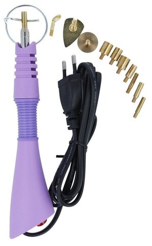

I would only recommend PVA (white) glue. You can wipe off any excess with water and it will be a stronger bond. The downside is that it takes longer to set, but if you bend the planks sufficiently so that they lay in place it's not a huge problem. Plus if you have an electric plank bender you can "iron" them dry.
