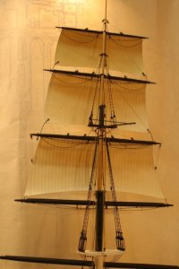

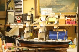

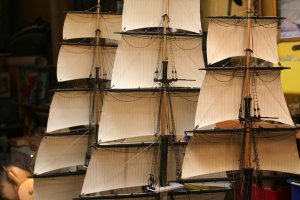

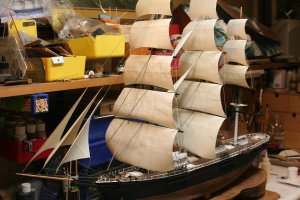

I'm entering this log long after I have laid the keel....and am entering the sail install. I do apologize.
I will refer back to other build aspects as I progress.

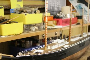

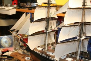

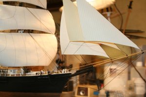

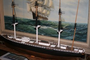

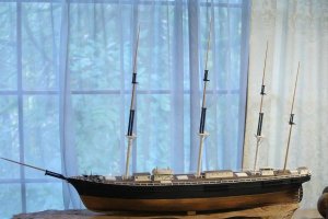

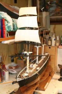

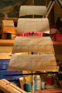

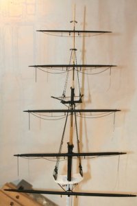

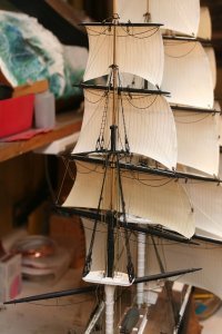

This last week I set the mizzen mast. This build has taken me down another math of construction I have never traveled. I rigged each mast with yards and sails to the upper topsail...leaving off the lower topsail and main course to afford easier access to rig the main shrouds and ratlines.
I have much to do, but here is the state she is currently in.
And an image of a painting she will represent.
IMG_8824_JPG_ad484009eed31a13f4cc418d54225795.jpgIMG_8741_JPG_1a0dc85ec7e91c1c337776fb227f4406.jpgIMG_8736_JPG_04640666ff9381f90859656809e2e550.jpggreat republic3 (2).jpg
Many Thanks for sharing with us your built - not easy to make a good model in this small scale - looking very good
BTW: very interesting vessel :cool:

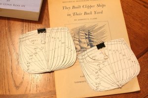

So I did my due diligence, and researched her for 2 years prior to her build. Found plans that needed much correction and began in 2016.

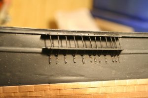

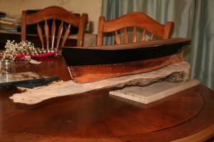

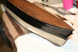

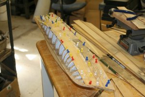

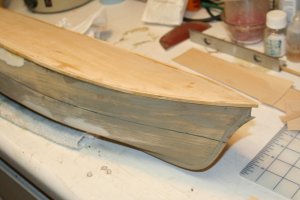

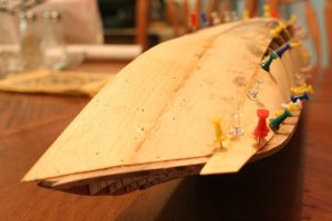

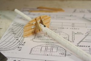

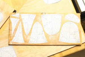

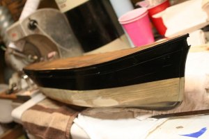

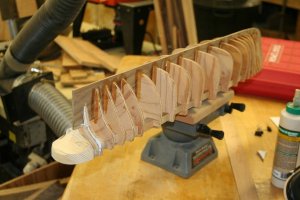

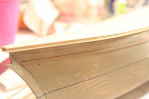

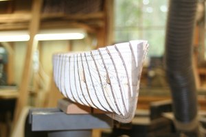

Here are some images of her POB hull being made.
Rob
post-2739-0-90895600-1467317924.jpgpost-2739-0-56927100-1467403610.jpgpost-2739-0-38901600-1467229482.jpgpost-2739-0-92051600-1467495444.jpgpost-2739-0-35370100-1467822852.jpgpost-2739-0-37744800-1467664702.jpgpost-2739-0-06309600-1467495389.jpgpost-2739-0-70476100-1467823215.jpg

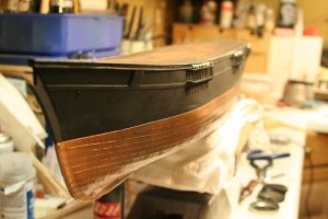

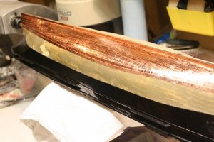

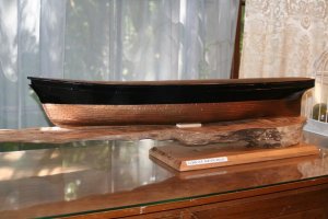

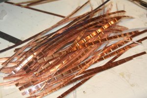

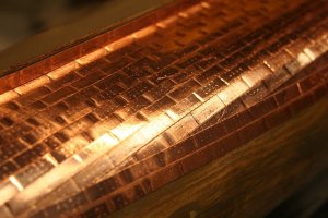

I was not going to spend hundreds of dollars on buying copper plates for the GR so I devised a machine, utilizing and old wash basin rolling ringer. I used wire mesh fencing, along with a strip of dry wall sanding mesh to create the nail impressions and pressed out 7 inch embossed strips of copper plates for the plating of GR.
post-2739-0-21436400-1469652100.jpgpost-2739-0-19788800-1469565309.jpgpost-2739-0-09034100-1469565338.jpgpost-2739-0-33159000-1470000775.jpg

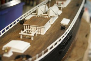

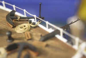

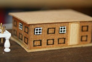

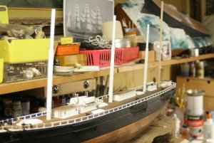

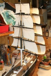

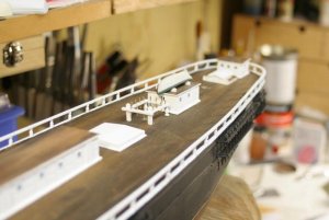

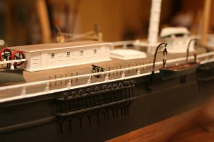

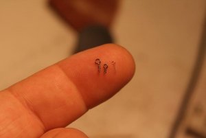

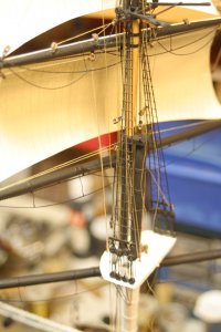

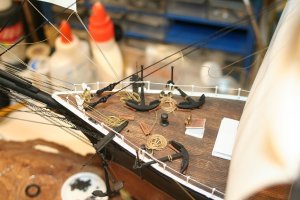

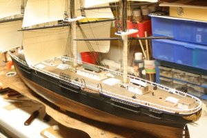

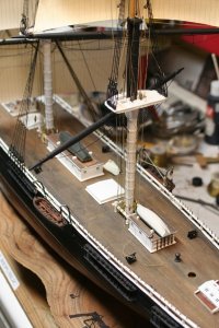

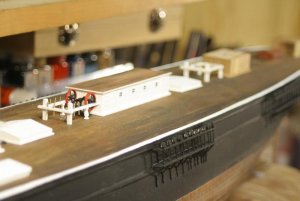

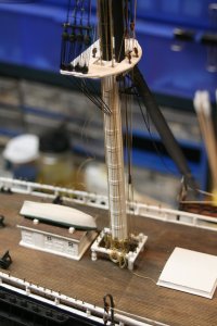

I did spend some time working on the GR..belaying and rerunning the lines that I had previously run for the sails and yards. Finishing with the rope coils before I proceed to the shrouds and ratlines. I made and added further eye bolts and rings to receive blocks about the model. here is where I left off. IMG_8830.JPGIMG_8832.JPGIMG_8835.JPGIMG_8838.JPGIMG_8841.JPGIMG_8842.JPGIMG_8846.JPGIMG_8845.JPGIMG_8834.JPG
