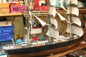

Thanks for all the likes and fine comments.

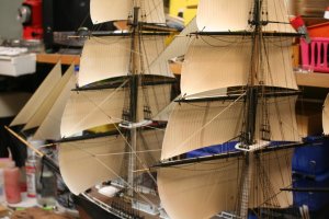

I figure I have the stays and shrouds/ratlines up next....then finish off with some final details(flags and rope coils) and boom and gaff braces.
Not much longer and she'll be dome.....5+ years in the making.

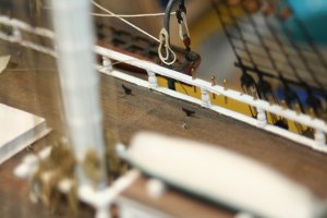

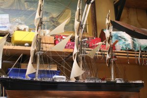

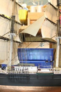

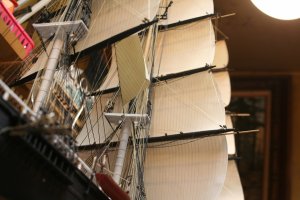

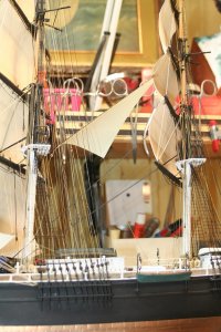

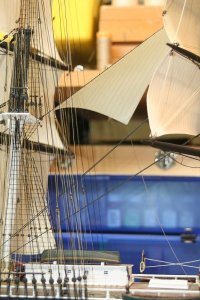

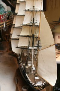

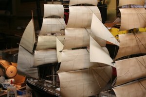

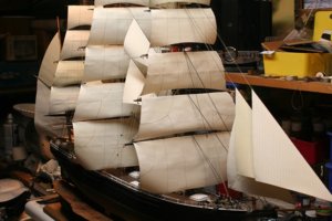

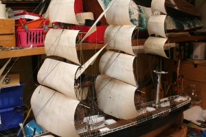

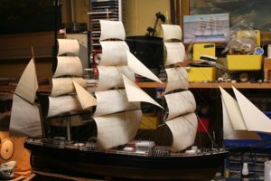

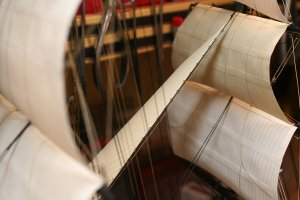

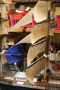

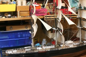

how do you get the staysails to stay flying like that ?
Welcome clipper Randy....I assume that name is because you like clippers.....?
Well I suspended the stay and jib sails by means of using extremely thin stainless orthodontic wire for the sheets, then painted running rigging colors.
Thanks for the question....

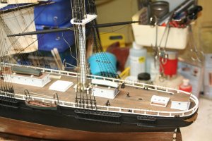

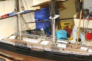

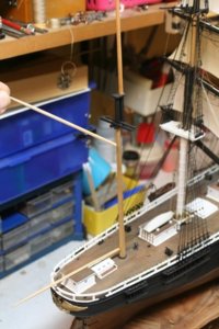

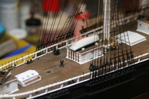

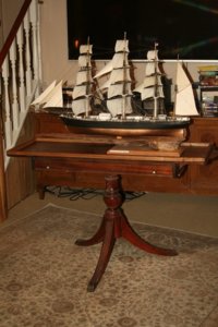

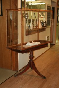

I test fit the GR on the base of the case stand I'm building...and an image of the case built.
RobIMG_9299_JPG_98ea0aa6ea8ed8fcb0b047e02cc19fd4.jpgIMG_9310_JPG_dc295616cf21a0f9d0a11fcdb4cfb424.jpg
