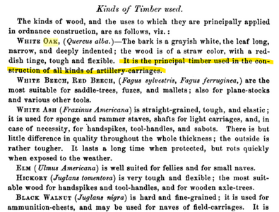

The Spanish cheeks (1600's) often used Mahogany. At Jamestown, some used Cedar (there was a report), and French colonials used this timber. British specifications in the mid-18th century called for checks and transom of the dry Elm which was very pliable and and not likely to split, but some carriages were made from yang oak, and oak was a standard for the United States garrison carriages until it was replaced by wrought-iron after a Civil War.

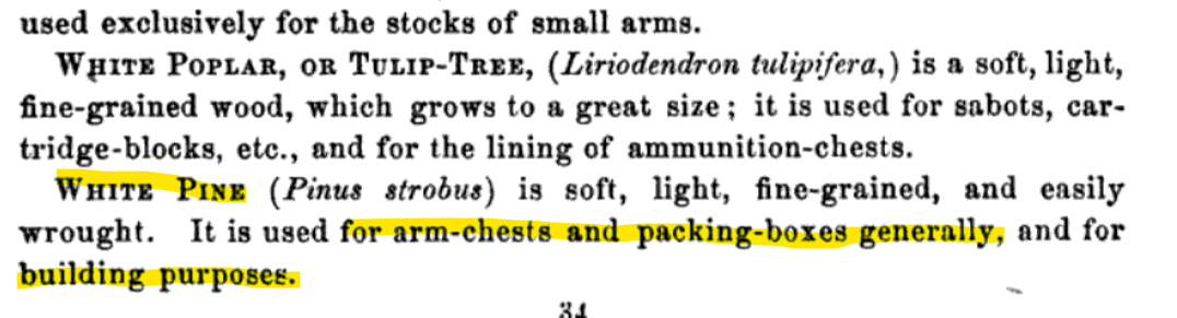

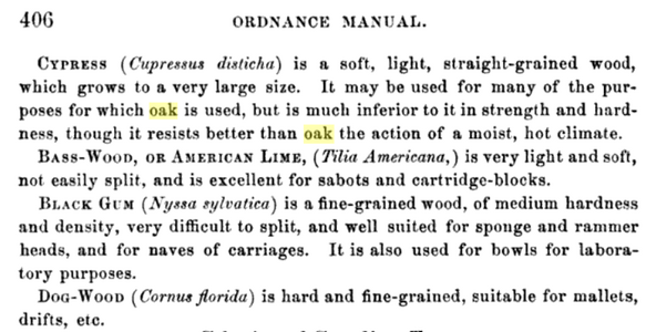

Here's an 1862 Ordnance Department breakdown
The basic structure of carriages were of elm, chosen for its ability to absorb shock and its resistance to splintering when struck by enemy shot
