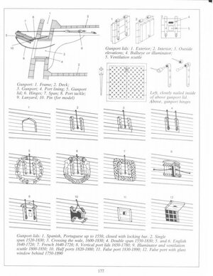

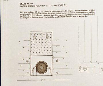

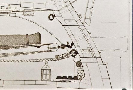

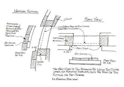

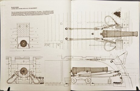

The gun ports were not framed with areal frame, but the futtocks or top timbers of the frames were partly visible and used as a port stop. At the bottom the stop was produced by the lower cill
Jean Boudriot

Mondfeld
