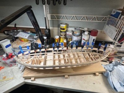

So after some time I started getting ready to attach the bulkheads. Except for #1 & 16, the others are in two piece sets. So I used a few of them to temp place in the keel and using a small square, I marked lines on the bottom to keep the bulkheads square and straight across the width of the hull. Then started the slow process of gluing, cleaning up excess glue, and clamping with my Lego blocks to keep things square. It is nice that Oklahoma City has a official Lego store in the mall, so I could go buy enough pieces just for ship building. The Admiral forbid robbing of the grandkids Lego stash.
Then working every other bulkhead set I started gluing them all in, alternating location of my blocks, as some spots were tight on spacing. When done I carefully added #1 back after repairs and all will sit now overnight to glue up.

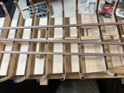

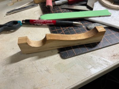

As Olha did on her online build, she used kit wood and dyed it black with ink, I found a source who got me some nice scraps so I could cut down the wood and make my own accent wales for the boat.
Thanks to the supplier for the wood, and it gave me a chance to use my mini table top saw and my Model Machines thickness planer.
No to just get them installed correctly, so I don't have to remove and reinstall like Olha did!

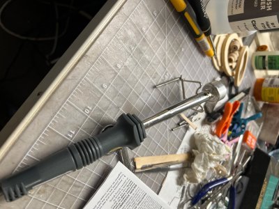

I dug deep into hidden tool box used years ago when I started ship building and found my new, never used plank bending tool. I know it’s new because I dug around the tool box looking for tool rest to support the hot end, and after 10 minutes of moving and looking I gave up!
But when I took the twist wire off the power cord the support stand was in the power cord bundle wrapped in with the twist tie!

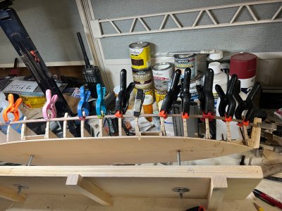

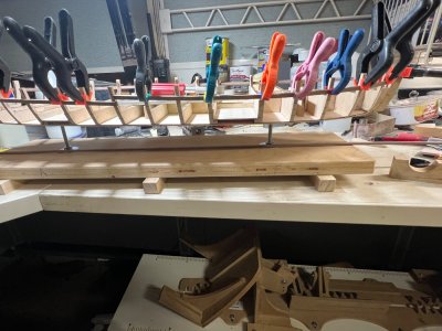

So kind of following Olga as she showed adding wales I cut and sanded one end and test fit till I liked it and then dipped the wood a while and started working with bending to fit.
I cut the first piece a bit long to allow final trimming when shaped.

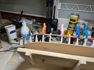

To keep things level, like Ohla, her idea worked great, I made a little jig to measure down from top of bulkheads to align the wale. Then I started clamping and adjusting to shape and fit.
After aft section was done I did the same steps over on forward piece to get it attached.
Now waiting on it to dry to shape for final trim and gluing up on next work day.

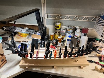

Well I have been feeling good last few days on planking.
First let me say I am following planking size and spacing from the kit materials and instructions.
As Olga has show the kit isn’t a exact match to plans of real ship!
That being said I have now worked for last few days to sand, shape, curl, twist and shout. What was that a song?

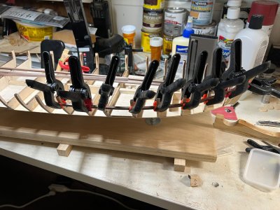

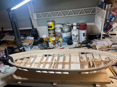

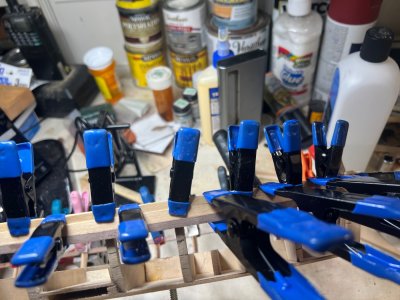

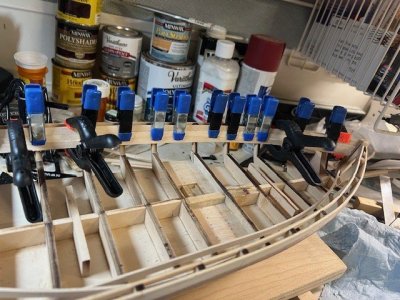

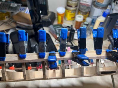

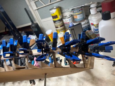

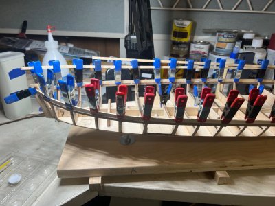

I now have top three rows of planking installed and gluing behind all the clamps.
The three rows in kit were actually just two rows on real ship.

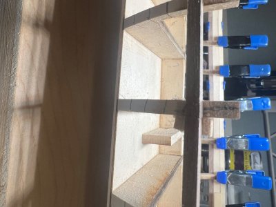

Here are photos of work. I did use a few spacers between bulkheads to help keep rows of planks smooth with each other.

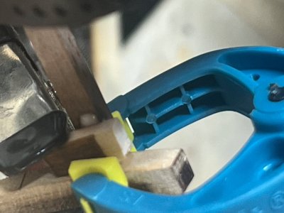

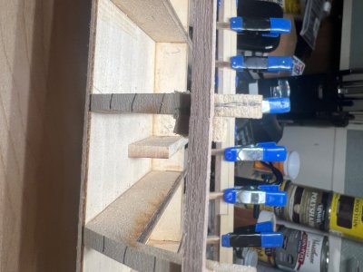

This photo shows extra spacer glued to bulkhead where plank joint fell short, so I added backing and glue to mount it. Can’t tell by outside

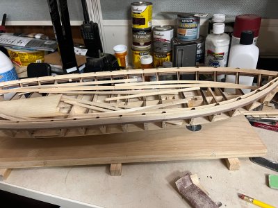

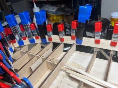

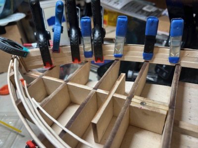

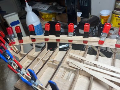

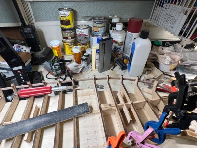

More plank work today this time I have started the interior ceiling planks. Kit has them at 1/4” for all, not what original had. Plans call for top row to go even with top of bulkheads and external planking. This has a rise in the forward section which caused the number of planks to increase forward at bow versus at back end of forward deck.

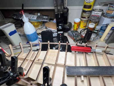

I got all four forward rows sanded and bottom one had to be cut at angle and notched a few times. None of that will be seen as it’s covered by deck!
I got aft top three rows fitted also, and had to stop for the day as I ran out of clamps to hold lower levels. Aft will go down another two or more rows to include down to floor board in step wells.
Aft end mostly straight planks
Bow planks cut and notched to fit angle

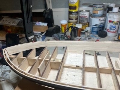

So here you go, as shown in last years photos, I spent time the other night gluing in the inner ceiling planks on starboard side. They will need some sanding to smooth them out when done.

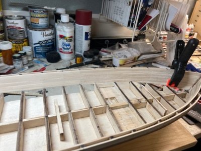

Well after a few days of prep and getting some PVA spread around, I have the Starboard side inner ceiling planks installed. I used the planks from the kit, not trying to stay accurate to plans. I don't have that much attention to detail for this kit yet.
I did get some grinding done to smooth out the planking, trying to get reasonably smooth, but I don't think they will be perfect, and based on history and design of this original ship I don't think they were built to the same standards as the big ships were.
