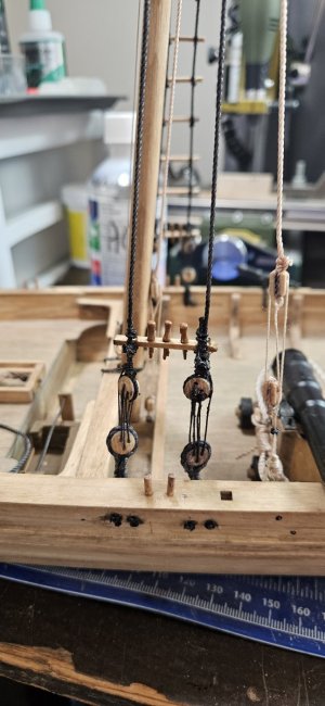

I had to pull apart the first of the lower deadeyes after I had it installed. Didn't realize that the 3 holes were canted about 30-deg off to the right until I looked at the photo I took. Small 'oops' but recoverable. Used some thin CA to stiffen the ropes that are around the deadeyes and hold them in position. (And, thankfully, avoided gluing my fingers or hand to the hull.)

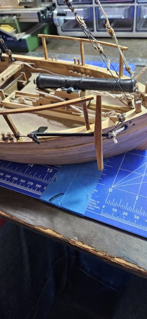

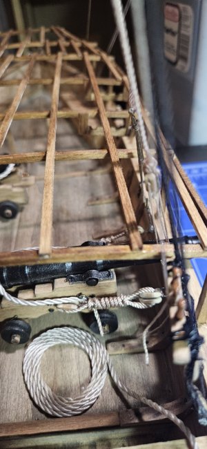

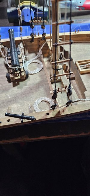

Have the 9-pounder cannons in the waist rigged; the 12-pounder in the bow is next.
The blocks needed some shaping; my attempts aren't the best but they at least look a bit more like they should. The holes in them also needed drilling out to 1.6 mm so the rope used for the side tackles could be threaded through them.The instruction book said to use wire for the stroping of the blocks; the drawings show both wire and rope. I opted for wire for the 9-pounders; am thinking I may use rope for the 12-pounder as that would be more in keeping with the period. Will make that decision another day.
The pictures show the work on the blocks and the preparation of one of the side tackles. I was going to dye the rope black (using a permanent marker) but after looking at some photos of cannons on the USS Constitution (OK, constructed 20+ years later but still a near contemporary) I decided to use the uncolored rope. (However, the picture of the prepared side tackle is with the dyed rope. I changed course after making this one.)
Along the way I ran out of the eye bolts that came with the kit; not sure if there weren't enough supplied or if I dropped some along the way. Anyways, to make up the 8 I was missing, I formed them from straight pins (after cutting off the heads). The result was as close to the kit supplied ones as I could get them; pleased with the result.
After attaching the side tackles I decided to wrap the falls around the tackles instead of creating a coil on the deck. From looking at photos of the Constitution, and from doing a bit of research reading, this was probably more the way the tackles would have been stored before preparing for action. I like the look (even if no 2 wrappings are exactly alike!).

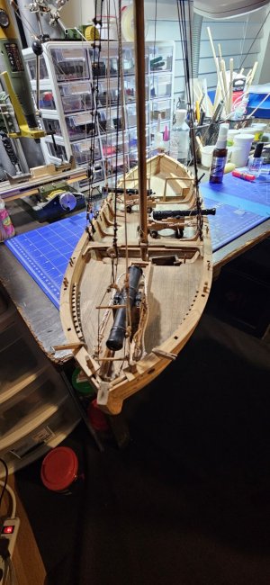

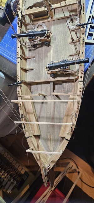

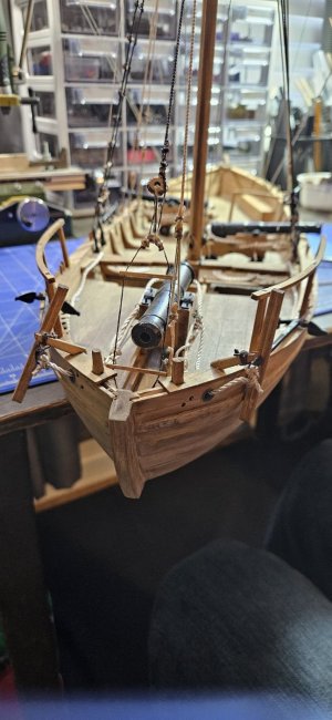

12-pounder bow gun is mounted on the slide and rigged. Before doing this I needed to construct and install the forestay spreader. This allows the bow cannon to fire unimpeded by rigging. The spreader is tied to what will be the forestay which is held in place by a temporary mast. Instead of using wire to strop the blocks for the gun's rigging, I used cordage and homemade hooks made from the 19-gauge wire in the kit (a bit more work than using wire but closer to actual practice; enjoyed the small work - and only glued fingers together once!).
Rail caps, stern railings, cat heads, mooring bits (either side of the bow), additional bitts on each side, thole pins, cleats & swivel gun brackets all installed. I added nails to the swivel gun brackets (they have holes in them) and ran out of the supplied nails. Had a supply of brass pins (left overs from a previous model; found in the container previously mentioned) of the right gauge but too long; snip, snip and more nails. Finished the swivel guns and added them onto the starboard side (they can be moved around if I decide to do so). Like the bow cannon they are a bit heavy in the breach but the paint adds just enough friction so they stay where tilted.

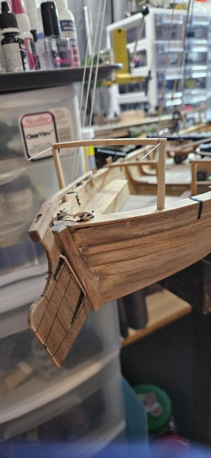

Finished the rudder. Used thick CA to fasten the pintle pins instead of soldering. Easier at this stage as I'd already painted the brass pieces black so they look like ironwork. Managed to get the gudgeons in the correct locations so that the rudder hangs properly. Decided to add the hole for the stopper rope and the rope (perhaps a size to large for the scale but I had a length laying around so it was used).
After getting the pintles glued to the rudder I decided that the holes in the pintles needed to have nails added. I could have filled each with a blob of paint or cut heads off nails and glued them in. I decided paint wasn't the way to go and I didn't have a stash of nails I could cut the heads off of (and I decided not to cut heads off of pins but that would have worked). Instead I made my own small pins (used 23 gauge wire) to simulate nails, drilled the holes through the rudder, inserted the pins and bent the ends over to secure them (could have used straight pins since they have heads but I decided not to as the holes in the pintles are small [0.5 mm] and the pins really need 0.8 mm holes to go through smoothly). I couldn't make flat heads on the simulated nails so they are just bent back to create a small eye that can't go through the holes. I think it looks good even if not accurate.

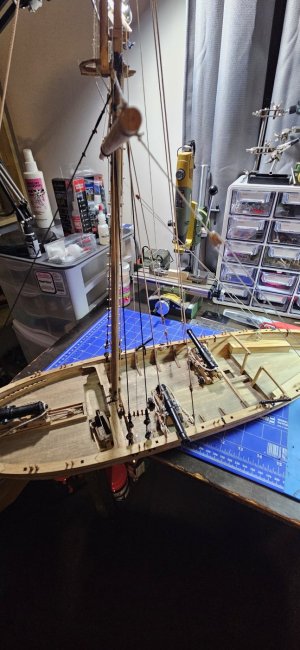

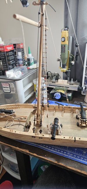

Back from one trip and heading out on another.... Was able to get the main mast, top mast and main top assembled and in place on the boat. Forming the mast ring was interesting as I'd already painted it black along with all of the other brass parts and it needed annealing before twisting in. Scrapped off the paint, annealed it, formed it and repainted it (pretty simple work; nothing onerous). Once again, not enough brass nails came with the kit so it was into my leftovers to find some that would work (if I need any more I'll be using dress maker's pins). The masts are a bit oval in cross-section instead of perfectly round but I'm happy with how they've turned out.
When I get back from this trip in a couple of weeks I'll prepare the spars and then start work on the rigging. I am aiming to have the model completed around the 3rd week of April.

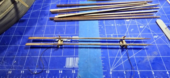

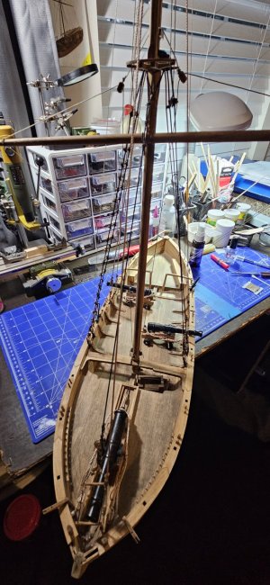

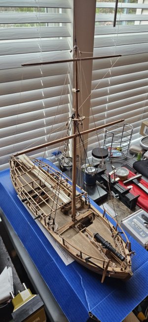

Back from some vacation and getting ready to go on a spot of work travel. Had several days in-between so was able to get the spars done and the rigging started.
Just before heading out on vacation, I tried to carve the topmast spar into shape. Had one side down to octagon and was starting to sand to round when a portion snapped off. Put everything aside and figured I'd put the remaining stock (luckily there was enough left for the spar) on my Proxxon mini-lathe when I returned. While on vacation I came across a thread (one of several) on tapering spars (or masts). Interesting reading that confirmed my decision to use the lathe.
The Proxxon has a headstock that the workpiece can be inserted through and held using collets; useful for turning long round pieces. I marked off the topmast spar (center, start of taper, desired end diameter), placed it in the lathe and did the turning using various grades of sandpaper. For the mainmast spar I used one of my carbide turning tools and then sandpaper. I didn't get as thin at the spar ends as the drawings show but I'm pleased with the result. (I bought the Proxxon DB250 a couple of years ago but other than doing a test piece hadn't used it yet. When I decided to get into lathe work last year after taking a couple of classes, I bought a large one [not suitable for small model work]. The DB250 fills the need for a small lathe for turning masts and spars. Will need to do more experimental work with it.)

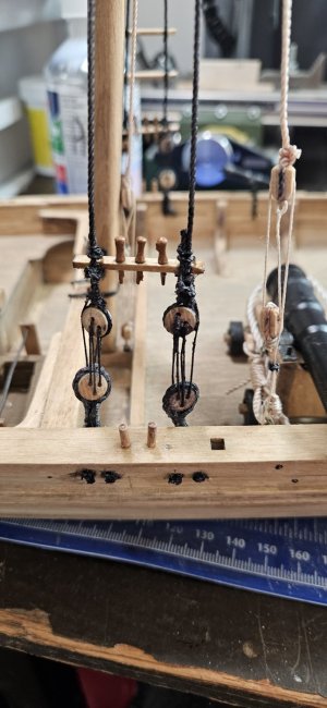

I used cut off straight pins to hold the spars on the masts while rigging (this was in the instruction book). First was stepping the main mast and fastening the halyard in place; then fastening the downhaul to a cleat at the base of the mast. Fastening the halyard involved forming a block-and-tackle arrangement with the halyard at the upper end of the tackle and the lower block hooked into an eyebolt just behind the base of the mast (the first of many small knots). This is when I decided to not use the small line that was supplied (a full synthetic) as it didn't hold the knots very well. Dug through my leftover box and found some small line that is a mix (polyester/cotton I suspect) and holds small knots better than the full synthetic.
For the mainmast backstays I fashioned the hooks at the bottoms of the two block-and-tackle set-ups from straight pins (not enough brass eye-bolts in the kit). They are reasonable but if I need any more I'll form them from long brass nails (have some in the leftover box). I puzzled for a bit over the attachment points for these hooks; it seemed that there were not enough eyebolts (or ringbolts) available. Finally figured out from a couple of the drawings that one of the eyebolts for the port 9-pounder cannon is also used as the attachment point for the port main mast backstay block-and-tackle. (The point here is that the instructions often leave out some clarifying information so one has to be able to read the drawings and figure things out. Definitely good practice for future endeavors.)

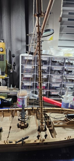

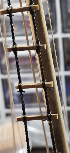

The starboard shrouds are done, the pin rack is installed and the ladder rungs are glued on. The bottom 3 (pin rack and bottom 2 rungs) are also tied on. (32 more small knots to go; will tackle them when I return from the work trip.) I used a jig (piece of scrap wood and 4 straight pins) to get the deadeye spacing right.
(Just a couple of notes. (1) I've used black permanent marker to stain fixed rigging [that which supports masts and spars] and left the running rigging [everything else] in the natural color supplied with the kit. (2) I have made a liberal use of PVA, CA and nail polish to hold rigging to deadeyes & blocks while tying them off; to secure rungs to shrouds; and to finish off knots.)
Next will be the port shrouds (no ladder rungs on the port side) and then the forestay. Then the rigging for the main spar followed by the rigging for the topmast and spar. Then there are the sweeps, awning structure and awning. Probably another 2-3 weeks before I get it finished.

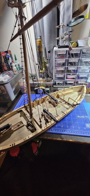

Have finished installing the shrouds (small knots holding on the rungs were difficult for my clumsy hands) and will now start on the main & topmast rigging. Slow but steady.

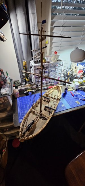

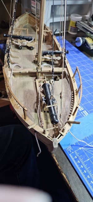

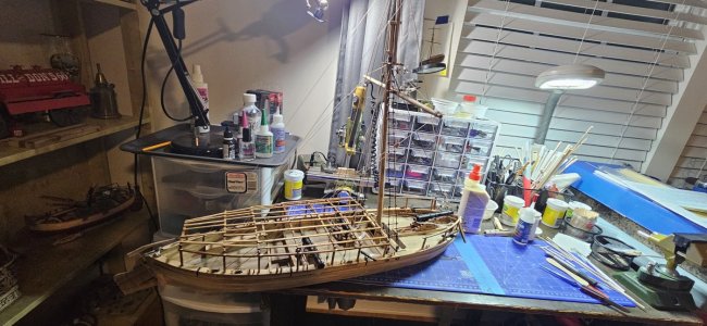

Work on the gunboat has been slow but steady. Have the topmast installed and all rigging completed. The hawse lines are coiled and waiting for the anchors to be built and installed. Travelling again next week so it'll be early November before I start work on the final portion - anchors, fore rails and awning structure. Should have it all completed by mid-November - except for the display case that I plan to make. I hope to have everything done by the end of the year.

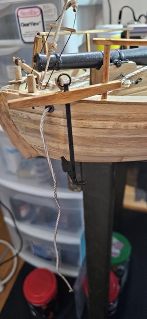

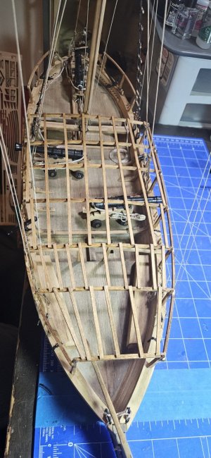

Have the front railings installed, the anchors assembled and hung and the framework of the awning structure started (following the build instruction suggestion to use straight pins to temporarily hold the framing pieces together). Still work to be done (more small scale carpentry, canvass preparation (the awning will stay folded & stored) & finishing the sweeps). The end point is getting nearer.

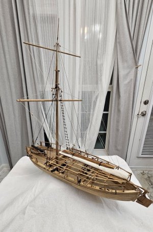

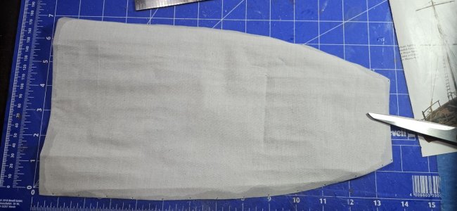

Finished the awning structure, cutout & rolled up the awning and prepared the sweep hold-downs & 1st two sweeps. That will be all until late December as I am doing some travelling for the next 4 weeks. Will finish the sweeps when I return, take some staged photos of the completed model and then start work on a display base/case.

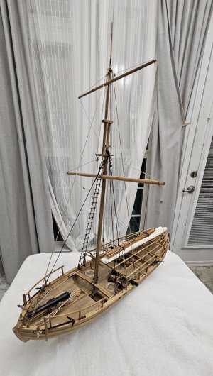

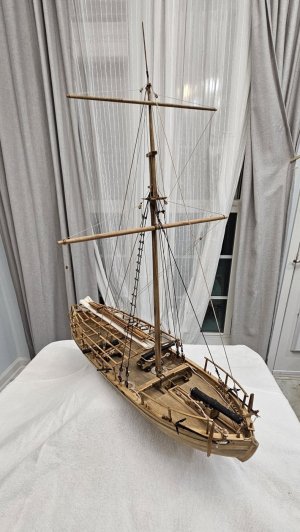

k'Finished. Will work on a display case after the New Year arrives. This is a big ship so I need to figure out where it will be displayed - probably initially on the table beside my workbench hence the need for a display case to protect it.
Although this one took a long time to complete, I have enjoyed doing the work on it. Always something to learn and re-learn. (Note, for instance, that I got the stays adjusted just a bit off between the main and topsails so the yards are at slightly different angles. Not enough cordage to redo the topsail yard so it remains just a bit askew in relation to the mainsail yard.) The black repair near the top of the mast is a piece of shrink tubing used to hold the mast head on when it broke off during a move (I didn't have anything in brown in the electronics box - it was either red, blue, green or black).
I have 4 boxes remaining in my 'to do' stash - Wolseley Viper engine, English Pinnace, Santo-Dumont 14bis & USS Constitution. Before I tackle these I'll be building a ukelele from a kit I acquired last year. Have my 'work' more or less plotted out for the next few years.
