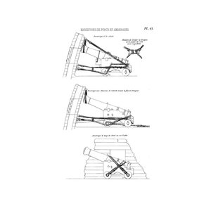

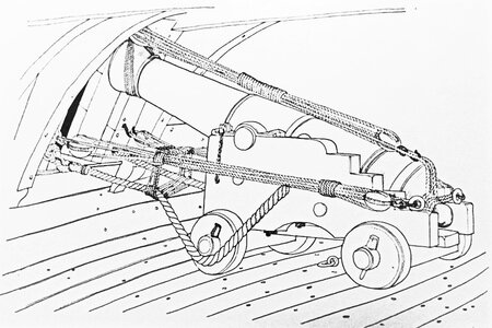

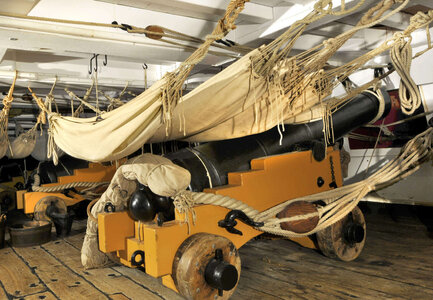

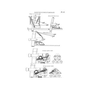

2) A lot of modelers do not know, how such a securred gun would look like (tackles etc.) - most publications are showing guns "ready" but the normal situation
French guns
This would be a typical situation
