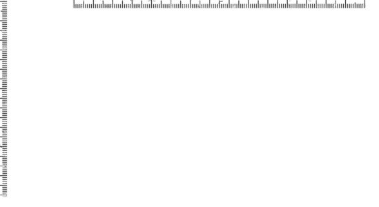

Until I was totally confident in my process I added a layer with a metric scale that should print out as accurate to the top and another layer at the side of every print out:
I am with you! I always add a six inch scale to the drawing. I will be adding a second one as in the y axis as well after seeing your example. I have had 48 inch pages printed in the past and once in a while they have been off, one time by as much as 0,25 inches which is a lot at our scales. The printing service was happy to adjust their machine and get it right.
