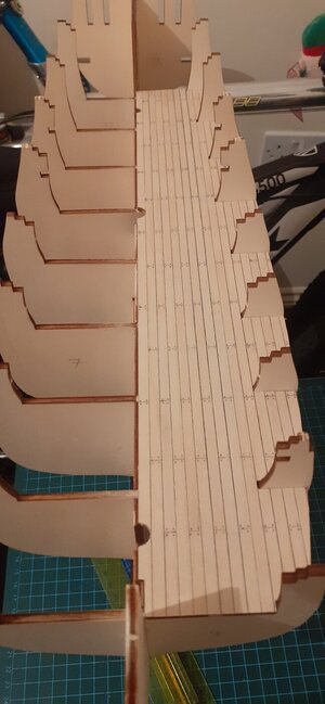

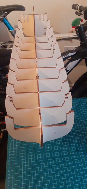

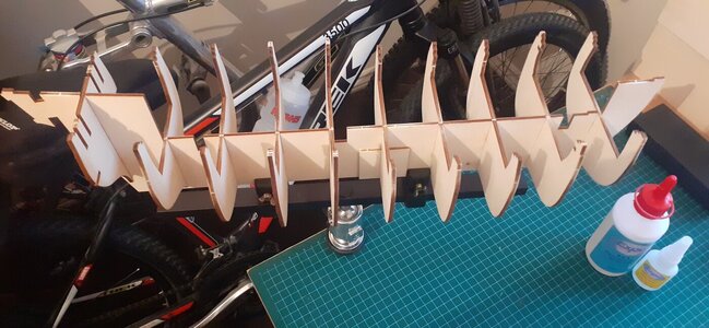

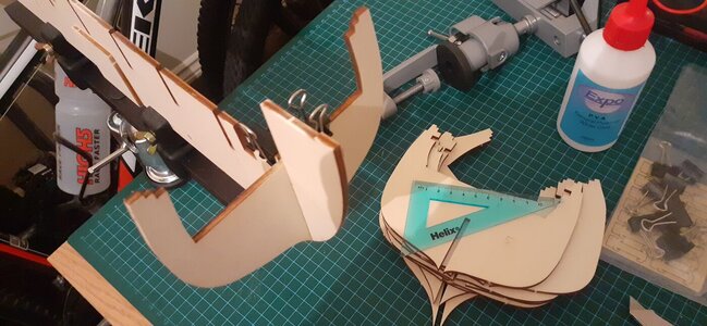

ENDEAVOUR 1/54
Early days in Construction

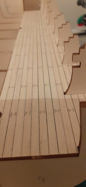

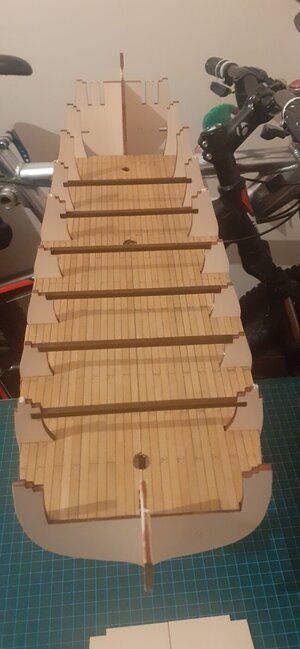

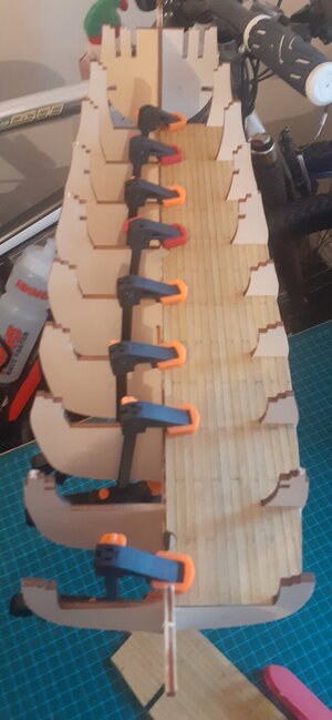

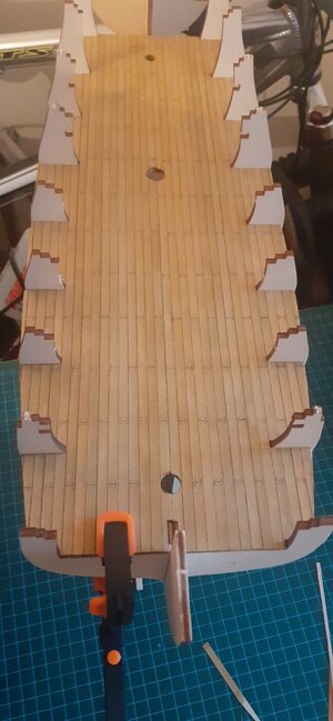

False keel built, Ribs in place, Lower deck Caulked, Planked and installed, brushed with Occre's Oak dye. Beams cut, brushed with Occre's Walnut dye and installed.
Next up Main Deck planking and Caulking.

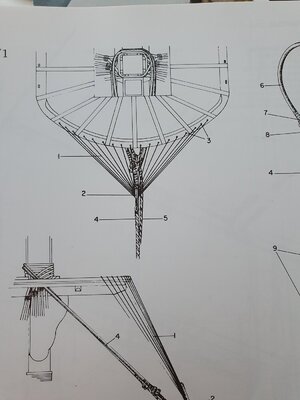

I found the kit and the materials to be of good quality. The instructions and drawings are good until one gets to the rigging. The instructions for the rigging could be more detailed and there are some errors, e.g. the number of holes for the crows feet and euthroes are insufficient. (Pic below). OcCre calls for 10 holes, but 18 are needed. Also, the euthroes are longer than given on the rigging plan. I spotted this mistake after I had glued the lower masts into the deck so remedial action will be difficult, so I may leave them as they are. Therefore, it is wise to plan ahead! The AOTS from Marquardt plays an excellent supporting role when building the ship, especially for the rigging.

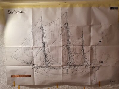

Hi Robert,
Below is the drawing I spoke of previously. It wasn't in my kit. I used the drawing to compare the position and dimensions of parts in the photos. Some of the positional dimensions of the deck components in the photos were incorrect.

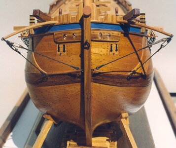

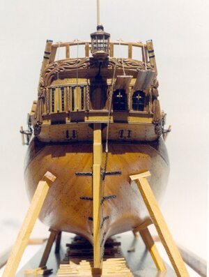

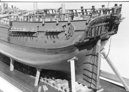

Ray Parkin's excellent volumes on the Endeavour seem to be a good source of information. Do the books contain fold-out drawings of the ship?
I noticed when scouring the Internet for his work that the Endeavour's stern is shown to have 5 windows. As far as I am informed the middle window was not used and was blanked off. Also, the stern did not carry the name of the ship.
Trevor
The plans are contained in the second volume. Ray's work is inspirational. There are however 3 main points of contention. Endeavour had only 4 stern windows. As did all ships os similar design. This is confirmed by Bligh in his journal where he stated the area where the sham window is was stoved in by following seas. Karl Marquardt nor I could convince Ray that this was the case. Second is the bookings. Ray, Karl and I had discussions about them but Ray preferred the idea that they were handrails for the seats of ease. Third is the height of the mizzen mast. As a rule of thumb is that the top of the mizzen mast is level with the main top. This is achieved by stepping the mizzen in the lower deck. As detailed by Karl. This can be supported by numerous draughts of the time depicting this.
Ray's other work is equally impressive. His paintings of butterflies and insects are fantastic. His life is detailed in an autobiography and how he survived Changi is really worth reading
Allan.
