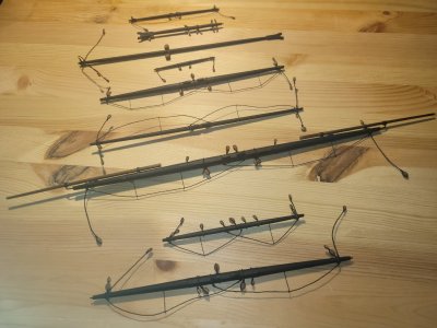

I had some complications with Caldercraft mat lacquer that I tried to use. For the hull exterior, I opted for "Flood" outdoor wood oils. They have a few nice colors, so I also used them to paint the masts.

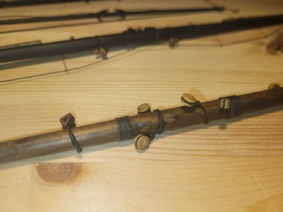

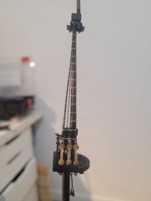

Also made some progress with rigging; it is very hard to decide where to add details and where not. Still learning how to work with CA glue. The thread selected for rope serving was wrong, as it is polyester with a lot of very thin threads that come out every time I try to connect another piece of rigging to it.
