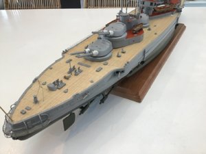

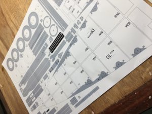

I have started a new ship build of the super dreadnought H.M.S Iron Duke in 1-200 scale. I purchased a card model for Poland, and I am using this for a reference for my build.
I thought that a fully planked and painted model was more authentic than using card, as some models finished in card to not pass close up scrutiny. ( in my opinion )
But then again, there's some beautiful card model ships on the internet, and I don't wish to make any negative comment. Its just my own opinion.
the picture below is the Iron Duke model in the British maritime museum, which I am basing my build upon.

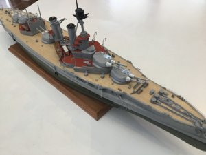

as a matter of fact, I purchased a 1-200 scale plastic kit of Milkasa for cannibalising some parts. I am using the davits, ships boats and other deck fittings, as she was originally built in a British shipyard and lots of fittings are very similar.
Very smart idea Brian and interesting build, something different. Are you using aluminium plate or also aluminium tape for this build. With tape you can also get great results.

With regards to using the Polish card model as a reference, I am gluing the printed card sections onto thin aluminium sheet with white carpenters wood glue and then cutting them to shape. I will paint these pieces at a later date.
I'm curious how thick the aluminum was and how did you cut it?

From memory I used aluminium flashing material on a roll, about .5mm thick.
