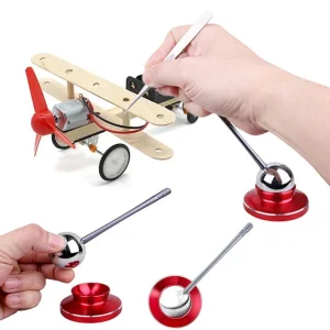

Hand stabiliser. Anyone use one ?

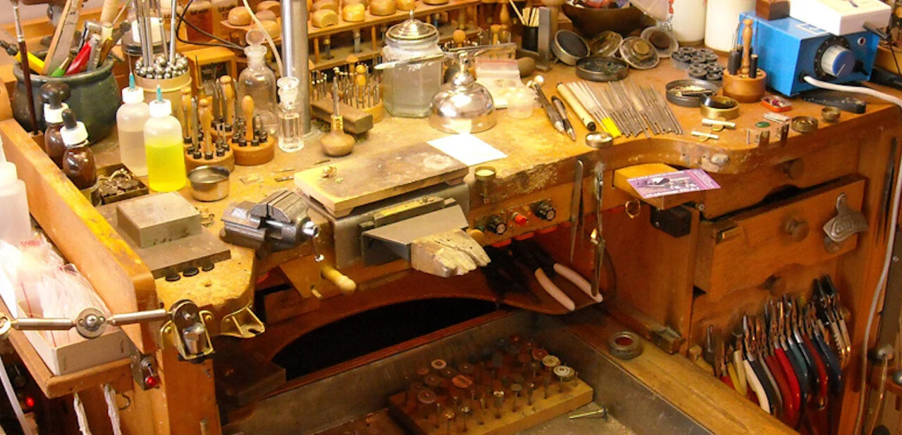

There are a few distinguishing features of a jeweler's bench.
  • The main (or "upper") work surface is at about the height of the sitting user's armpit. This permits the user to get "up close and personal" with the work for the best view. Most of us work on a "writing table" height surface, which is actually too far from the eyes for a lot of close work on miniatures.
The front edge of the bench top is cut in a "scoop" shape or similar to permit the user to rest their forearms on the "arms" of the scooped area to provide solid forearm support to keep hands steady. Alternately, as in the first photo below, some benches have articulated "arms" to provide this solid forearm support. This feature makes a huge difference in steadying hands and limiting fatigue. There are articulated forearm supports which may be attached to any table... for a price. Amazon.com : VIVO Universal Clamp-on Adjustable Armrest, Desk Cradle Rotating Elbow Cushion, Above Table Extension Platform Arm Support, Black, MOUNT-ARM01 : Office Products When the need arises next, I plan to buy a set of these clamp-on articulated ergonomic arm rests that can be attached to some sort of adjustable stand to permit their use when doing tedious rigging tasks, such as tying ratline clove hitches. Steady hands go a long way in avoiding flying parts, too. An example of a "store boughten" adjustable ergonomic forearm rest. Amazon.com : articulating arm rest (Two needed for jeweler's bench.) These are primarily marketed for use by tech industry keyboardists.

  • Jeweler's benches usually have secondary working surfaces at "writing desk surface" level, sometimes in a form that permits their sliding out towards the user. It may be used for storing tools or catching flying parts. Others may have even more creative solutions for the problem of dropped small parts. In the second photograph below, there appears to be an elastic-fronted cloth "catch basket" that does its job with no more attention by the user than the user's pulling up their chair.
  • Most jeweler's benches will have a "jeweler's bench pin," sometimes with a pin holder that integrates an anvil. This suitably shaped piece of semi-sacrificial wood is used as the primary working surface on the bench and generally replaces the "self-healing cutting mat" used by so many ship modelers. It's used to rest parts on for cutting, filing, and sanding. Some bench pins have a "forked" shape to be used in conjunction with a jeweler's saw for extremely fine sawing applications. (See the sawing pin on the third bench pictured below.) Bench pins are usually placed directly in the middle and in the front of the top working surface, although some users their bench pins wherever convenient. Around $25 USD https://www.walmart.com/ip/Jewelry-...Clamp-Steel-Block-Jeweler-Workbench/605151591

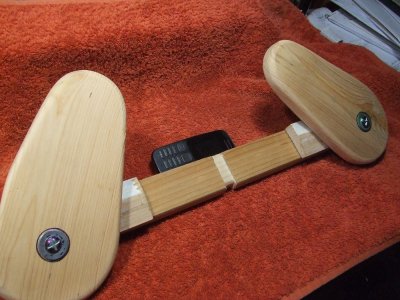

Hi guys,
starting to get some minor tremors in my hands due to my old age, and was considering purchasing a steady rest for working on my ship models.
Looking at the product made by Dspaie or similar. Just wondering if a member here has used something like this ?
thanks in advance.

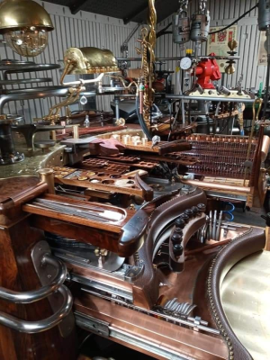

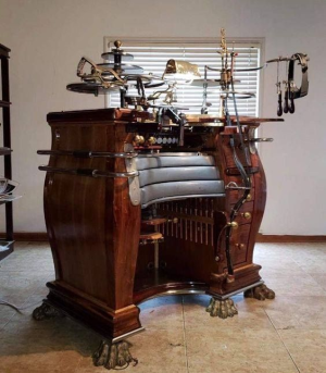

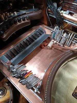

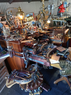

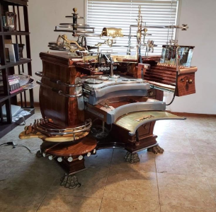

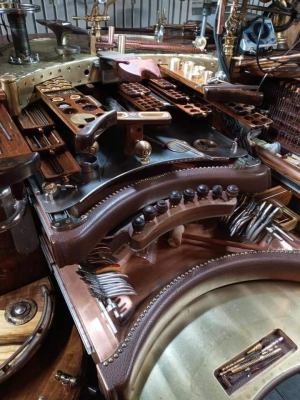

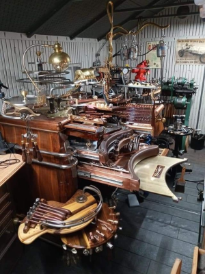

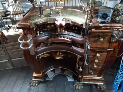

Show her a picture of this one below. It looks like a nice piece of traditional furniture but opens up to become the mother of all jeweler's benches! It may look like some amazing antique, but, in fact, it's a piece of "steampunk" art made in the present era. The metal drawer slides are the giveaway. :oops:
Tell her you're going to treat yourself to one. When the yelling stops and the smoke clears, you may come away with a compromise to build a lesser bench to your own design. This tactic has worked for me on many an occasion. :D
As a tool wonk, I really wish I could get my hands on this monster and study it in detail. Found these pictures, but no other information on this bench. They appear to have originated in a Russian jewelry making forum, but just as sort of a joke in a thread on jeweler's benches. No details as to the maker or origin of the bench. The Russian jewelry forum was interesting, though. See: https://www.jportal.ru/forum/

yep! had a look online and the many examples. The DSPAIE looks to be the best as far as mobility ie working on a table, switching to a different work surface instantly like me, where I use the grandkids students desk, the outdoor BBQ table and even the dinner table when wife isn't home or the coffee table when watching sport on TV. All during a period of an hour or day. Looks to be a fantastic "Pick Up n Go" modeler's tool for use on various scale models 1/200, - 1,200 PE, miniature figures and model ship hulls as in SOS. Best of all it doesn't require a permanent work bench space. It's on my Christmas suggestion list. Thank you Bryian for bringing this to my attention.

Hi guys,
thanks in advance.
Hi Brian,
Starting to note that a little myself; damn that ageing process. I'd be very keen to hear about how effective such a tool is. Will visit the web site and have a look.
