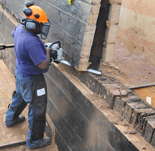

you can see here during repairs how close the framing is. There might be an inch maybe 2. so at say a scale of 1:48 the spacing between frames is around .020 thousandths.

YES - it would be a solid wooden wall, when the framing would be executed like the original structure - but this is valid for a lot of ships.
most of the POF models have simplified framing .....
But anyhow - as I know there is no POF kit available on the market
Dave thank you! The photos really capture your point. Almost enough wood for two standard hulls!

The hull of the Constitution is truly a solid grouping of woods. The exterior of the hull is close to 4” of white oak. The ribs are a combination of white and live oak with cross beam strengthred of live oak. Knees of live oak. Interior planking of white oak.
Look at the previous photos of the ship. You can see how tight the spacing is and how strong this hull is. It’s, as mention, the strength of this ship.
