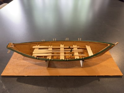

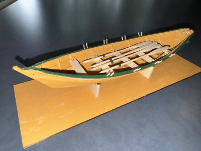

I have completed the dory as my first project and I’m working on the Norwegian Sailing Pram. I’ll try to include a picture of the dory.

Your Dory looks great !
