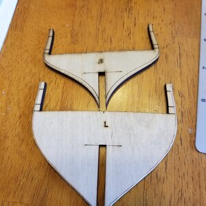

Greetings all. Dave from Delaware here, working on my 1st build in 40 years. I've decided to start big with the Model Shipways Syren. I've been spending wayyyyy too much time on here reading and learning. SO, my 1st question, which I 100% know the answer to, but I'd like to avoid disaster. Bulkhead L is towards the bow, 26 is the sternmost. After fairing the bulkheads to the line, the letter L faces forward. I assume the # 26 faces the stern, so the fairing curves toward the stern. This is correct, right?

Based on chapter 2 of instructions the tapered side faces forward on lettered and aft on numbers as you listed. Look for note in RED in page 7.
