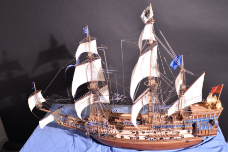

Flat sails on a model never looked good to me. In order to make billowed sails, you should choose a fabric which can stretch. You stretch the sail, wet it with starch, then let it dry, then fit it on the model. The technique shown in the video below is what I used to make sails.

Thank you very much, Darvis, for your advice.
I have been exploring your thread about the construction of La Couronne, and I find the technique you used to be amazing and the result perfect.
By the way, regarding the lighting of La Couronne, what did you use the Arduino module for?

The Arduino was used to flicker the lights. Each of the six lighting circuits flickers a tiny bit, each on a different, random frequency.
