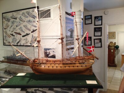

Hello Andy,
I have a question about the kit. I was given this particular model, built with a true love for the hobby, from an old friend who has long since passed. The custom base he put it on is too large for where we want to display it, and I was looking to put it back on a more original base. Without the plans, I can't see if there were precut base parts, or a design template I can follow to make my own. Is there any way you, or anyone, can assist me so I can make a base? Any help appreciated.

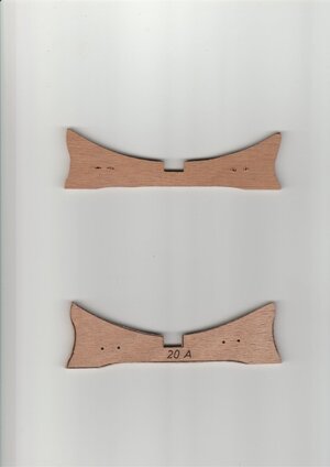

Hello Eroeder,
the kit I have is purchased before I was born, somewhere in the 70's, and back then the manuals of Billing Boats were very poor. Thru the years they improved and digitalized the manuals, this is the website : https://www.billingboats.com/index.php/modelboats-footer/2/120/boats/the-expert/P-bb437-norske-love. I checked my father his kit and he already cut out what seems to be the the two pieces of the base. I put them on the scanner and put them in the atachment, if you print this on an A4 piece of paper you have the pieces in the correct size, hope this is a bit of help, greetings

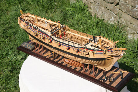

Hi,
It looks as if the ship is supported on two pedestals?
Look under the base and see if there are two bolt-heads under the pedestals. If there are, then the bolts pass through the pedestals and engage with captive nuts built into the keel. (This would be normal practice for pedestal mounting).
You can then prepare a smaller base and mount the ship again.
The downside of pedestal mounting is that on the larger ships the arrangement is susceptible to accidental damage, and can tear the keel out in the worst instance.
The support cradle that you have been sent is a safer option, but you might like to consider a design I have used on a number of ships, and mount the ship on keel blocks, as if on a slipway, and then prop as shown on the photo attached.
The hardwood base was prepared by my local timberyard (NOT a DIY store, they haven't a clue) with the edges routered to a nice profile. I then routed out the centre, laid down the slipway timbers and keel blocks, then bolted the ship down and added props at bow and stern, very like real practice. The 'gravel' is track ballast from a model train store, and the figures from Amati - they add a bit of life.
Hope this helps, and welcome aboard!
