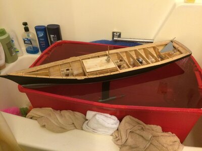

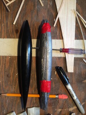

when everything is prepared and the centreboard / sword is installed, I would install a weight "bomb" out of lead, which can be adjusted
Testing of the trim with the waterline in the bathtub and add some weights for final trim inside the hull
Do not forget, that you will add with the deck, mast and sails some additional weight
