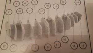

Now...I have a huge problem. The kit is missing two parts. Going from the parts list it's part No 17 (Fore Crotch) and part No 18 (Alt counter)
I'm just wondering where I can get these two parts from? Can anyone help please.

The only way how to do it is try to make it yourself based on plans. Maybe post here pictures of these parts and we can help you produce them somehow.

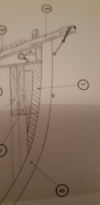

Thanks Matus, I'll have to make these parts myself maybe from Balsa...not easy but that's life. It looks like they are molded parts. Need to make No 17 and 18. 17 is not a problem the challenge will be with part No 18.

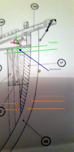

Dear Ed,
I have some experience in carpentry, what I would suggest is the part 17 is a simple L 90 degree profile, rotated clockwise 180 degrees where what I have I marked in orange part has been sanded, tacked, nailed , clamped or glue to fit. I assume the model maker (Artesenal) would use as much readily available off-the-shelf product and use the most simple and skilled labour free method of constructing his parts.
You mentioned "molded"- do you mean constructed like an architectural moulding like here made using either a moulding router bit or moulding plane?

Dear Ed,
Thank you for your suggestion. I have already made part No 17 with no problem. The hard part is No 18 because the lack of dimensions that the drawing gives. I will attempt to make it out of balsa wood when time permits.
