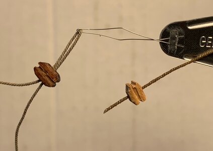

Instead of the needle threader a I am using a drop of CA-glue at the edge of the yarn and after hardening cutting the edge at an angle to make easier for pushing thru the corresponding holes while rigging. The advantage is you always pull or push the thread not doubled (sometimes it is not easy to pull the doubled thread) thru the holes and you have more flexibility to push the hardened thread with a tweezer to reach narrow and limited areas .I attached also a photo for better understanding.
Kind Regards and Enjoy Your Modeling

Thank you Korsan, I've used your method. But, I saw the threader method used on John Apiritis(?) Site and my dead eyes have .030" holes so I'll try that also I seems it could go a bit quicker.
