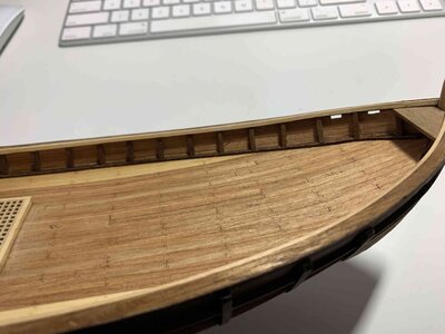

I used the search button and found multiple references for Amati Pinta. Here's a photo from a build log here showing the modeller has used walnut square stock from the kit.
Hope you might be able to figure it out, and wishing you all the best.

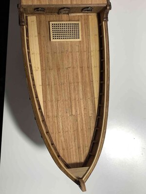

Here is my solutions:
I've just completed mine,the sizes of #25 & 26 are in the instructions - #25 = 2 x 1x1mm laid side by side to form 2x1mm (bends easier two ways than a single 2x1mm). #26 is 2x2mm walnut.
