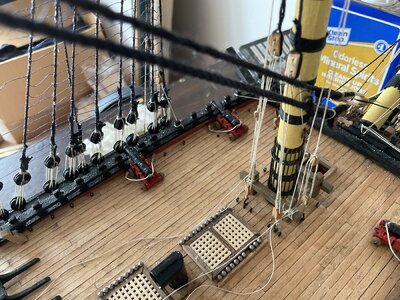

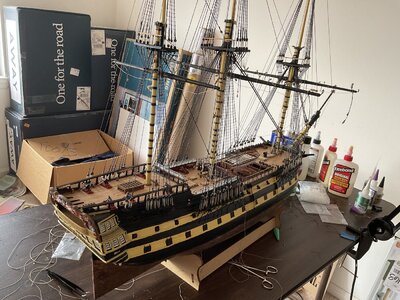

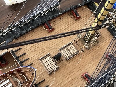

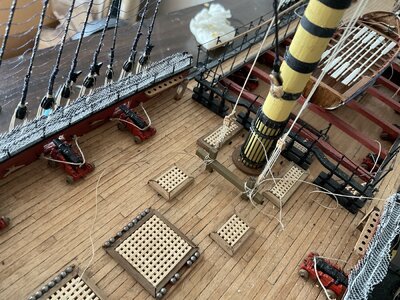

I know this is probably basic, this is my first real build and as retired surgeon I am a bit OCD with some aspects of this. I have to belay some rigging to the Cross bits, but I have been unable to find any instructions on the “proper” way to do this. I can find directions for cleats, and pins, but nothing on how to tie to the cross bit image.jpgimage.jpgimage.jpg
Just one point, your guns' breech tackle should have more slack, to allow them room to be re-loaded.

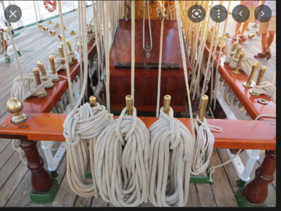

If you mean the fife rails by 'cross bits', then the rope is clove hitched back above the upper pulley block. (if I'm wrong, I'm sure some ABS will correct me)

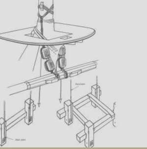

The attachment may be helpful for your wiestion how to tie the cross bit without belaying pin.
