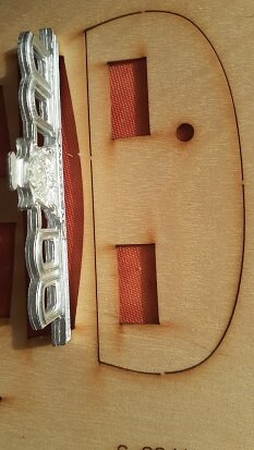

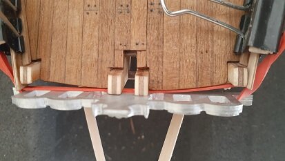

I am currently building Mamoli 1:54 Le Coureur and I hit a snag. The instructions say to bend the transom. How does one bend a metal transom without breaking it?
The metal type is not mentioned :-(
I contacted Dusek who now owns the Mamoli catalogue. I gave them the info they requested but i am yet to receive a response.
Any suggestion would help.
Here are two pics to illustrate the curve that the transom needs to match. Thank you in advance :)

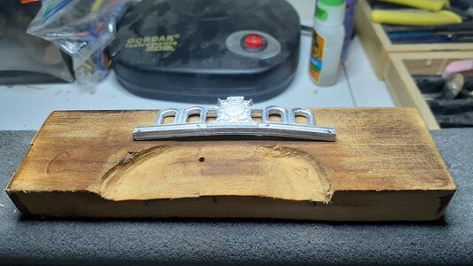

I shape a wood block to the exact contour, then I use a metal clamp to clamp the piece to the block in the center. heat each side with a small pencil torch and bend the ends into the shape needed, clamp ends till cool.
I agree, the alternative is that you could gently heat the whole piece on a stove and lay it on the jig, Less is more as far as heat--just enough to make it flexible.
I agree with Thomas, start with heating the oven to 300 - 350 with the piece on a jig, let it heat for 20 minutes and gently press onto jig. If too much resistance, try 375. Don't make your jig from plywood as the glues could soften and melt then the pieces separate.
Not sure i responded properly to all the help that was so kindly provided.

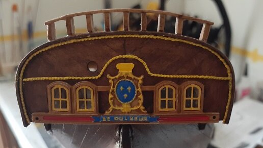

I want to thank all those who gave me good advice. I indeed baked the transom for 20 minutes and bent it gently. Here are pics about the jig i created and the results.
Again thanks all!
