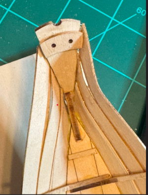

I saw another build log where they had a similar problem with the planks bowing in. I believe the suggestion was to wet the inside of the planks to allow them to bow out.
Waiting on plank bender then was going to wet inside and use bender to help push back out

Forgive me but I am a real noob at this. This is my first ever attempt and so I bought the 3-kit combo from Shipways for beginners. Loving it so far and already learning a lot.
But I really screwed the pooch on this one. How can I correct the extreme bend I have here?
I may have to get another of these kits and do it after I complete this one. Making lots of mistakes, but hey that's the best way to learn. Thanks in advance.

I too "screwed the pooch," on my Dory. I pinched the bow so much that I no longer had a Dory. A boat yes, but not a Dory. So, as much as it galled me I tore the bow open, lots of warm water and patience. Eventually, I built a Dory.
