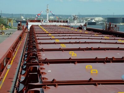

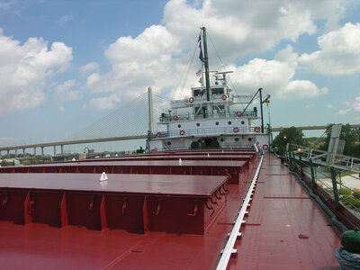

Doing a 1:200 and 1:250 scale Great Lakes freighter. These are my 2nd and 3rd builds as well so experience is low.
I want to be as detailed as I can of course. The hatches on thix class are quite complex/detailed with what i assumd are supports for the coaming as well as having some piping on each side that run through the support structure. Model is solid wood hull and been using balsa for other details. Any suggestions on how to approach these aside from leaving out these details? I was planning on using some type of flexible metal tube or rod for the piping.....if I don't end up skipping it.

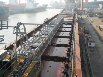

do you have drawings for the hatch and hatch cover or photos showing clear details?
i see what you have are more complex than these i assume the rail you see if for crane or gantry to lift the covers.

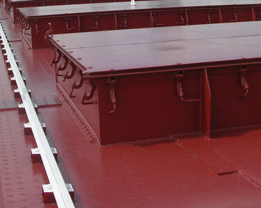

View attachment 226607View attachment 226609
The hatches for my Fitzgerald would be like these in the photo posted. The scale was small enough I could just stack a slight bigger cut of 1/16" balsa onto a smaller one, and not worry about the clamps, as these are so basic (simple shape).

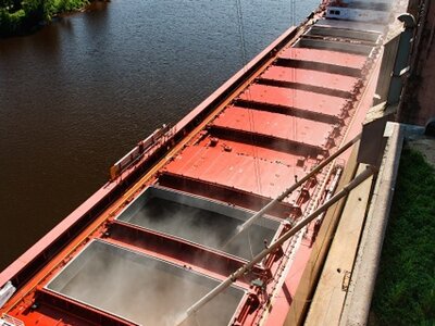

Here is a better view of the hatches, that show the piping running down both side of the ship. The gantry rail runs outside of the piping. The first one is the self-unloading sister ship of the one I am doing (I will tackled the unloading boom one day soon). The other shows a good detail as well.
I have the general hatch dimensions from the drawings I have. Somewhere in the files I got there might actually be hatch details, but I'd have to go through them more thoroughly. These 2 should help show what I am talking about though.
