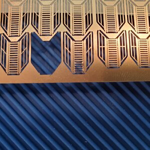

Hi. Can anyone give me some suggestions as to what tool and process to use to bend each individual tread on 1/350 scale inclined ladders? I can't even fit a pin between the treads to even them out with the deck and just end up bending the ladder out of shape when trying to accomplish this. I have ruined the first two I have attempted so I'm hoping I can get some help from the forum. Once the railings are bent to shape they are so delicate that I am having a problem even trying to hold them. If I bend them on the sprue I don't believe I can then use my bending tool to bend the rails so I don't know what the best order of bending is. I'm new to this and this has me stumped. Is there a specialized tweezers or other tool that is small enough to fit between the treads? Thanks in advance for any input.

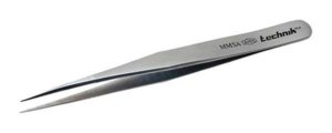

Hello Chris. Look for the one similar to the one on below picture

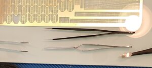

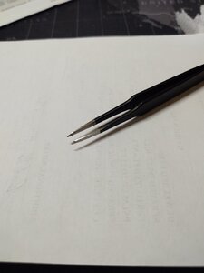

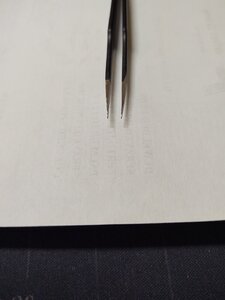

Is it possible that you are not bending the rails in the correct spot. The point where the rails and the steps meet is microscopic. These gigantic pictures are the tweezers I use. They are not totally squared off (sorry for the lousy description in my original) but they work. Good luck.

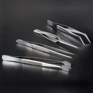

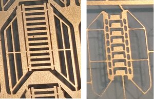

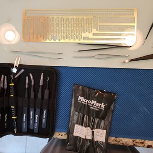

These are the two brands of ladders. The Toms have reliefs at the edges to allow the tread to bend. The gold Medal is solid all the way to the ends. Even if I can get something in there to fit I find the Gold Medal just distorts the ladder because there is no weak point to bend. The whole tread just twists and deforms everything. I know it's my inability because I see models with these looking great...I'm doing something wrong. The other picture are just SOME of the tweezers I have bought and modified to try and get one to fit in there. I have a bunch more and just ordered another watchmakers set today. I don't know how much I have spent trying to get something to fit in there. I am at a loss on how to do this lol. It may just be something I never master.20200509_115234.jpg20200509_122833 - Copy.jpg20200509_122833.jpg

Hello Chris, I am afraid to tell you the truth, but the Gold Medal versions of ladders (the one you show above) are not designed to bend! No matter what tools will buy, you will get a fiasco. :( Those ladders are not designed to bend. Tom's (the one on the top right image - Yes. They have the notch and designed to bent.
Thanks Jimsky. At least now I don't feel so bad. I could not for the life of me figure out how to bend them when there didn't appear to be a score mark on the treads.
