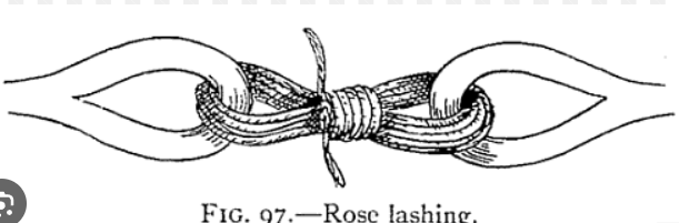

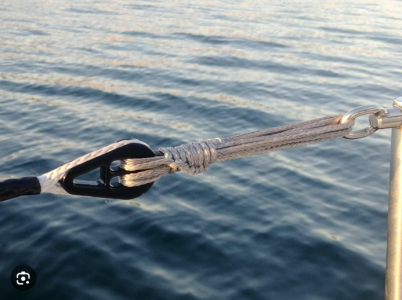

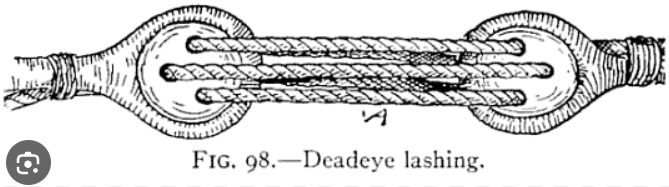

I do not remember when in ship rigging the tightness of the rope is achieved by making a know you describe. It is always with some sort of lashing of this kind or the other:
Every bit of standing rigging on a sailing vessel has some means of adjustment factored into in; be it dead-eyes & lanyards, bulls-eyes & lanyards, rigging-screws (turnbuckles); because rigging, even wire-rope, expands and contracts. Lines that get constant adjustment typically use block & tackle, such as running back stays, and the like.
Even lines that don't appear to have adjustment, or tensioning, tend to rely on another part that does; for instance a line from the bowsprit tip to the bottom of the dolphin-striker may not have adjustment, but the line from the dolphin-striker to the hull does, and it's tension keeps the other line taught.
