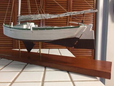

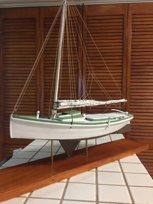

Tom Lauria’s tutorials demonstrate the method I use in making sails out of silkspan. Closer to scale than fabric would be.
