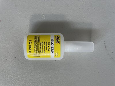

I use CA exclusively on all my models. I don’t smell fumes with the Locktite but the SloZap when used in quanity emits an odor. It does get a lot more expensive with CA when building larger boats but I like the sped up drying times. Also…as with any adhesive, knowing how to handle the product without gluing your body together is paramount.
