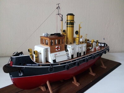

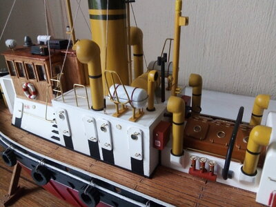

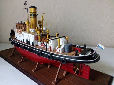

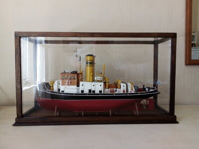

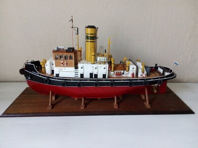

Hi. I've been building 1:50 scale models of the "Alwyn Vintcent", the last operational steam tug in South Africa, from scratch for a couple of years. I've used both original plans and plans I made from photographs of the actual vessel. The actual vessel is undergoing restoration in Villiersdorp, South Africa. I've sold 4 of these display models in a display case.

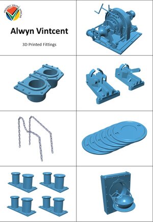

- Designed, and Resin Printed, 3D models of all the fittings.
