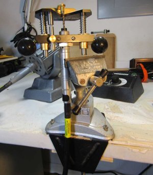

I have a Foredom flexshaft. StewMac has an accessory that is a plunge router.
Upside down it is a shaper. No fence - just roller - which not as fool proof - the cutter is 1/4" twist drill bit with 22.5 degree tip angle
The tool allows the bit to be angled. It was quick to cut the rabbet and if there was a fence I may have been happy with what it did.
The 45 degree wedge - shallow - that a chisel can work off of for the angle change that comes with a garboard going from near horizontal at the deadflat to almost vertical at the ends.
If there is an actual garboard instead of open framing - the angle of the meeting is hidden so it can be faked.
There is a TEMU mini router table so does AliExpress - Ali also has a Dremel version
The TEMU table is Al so drilling bolt holes is easy. The mount for a Foredom HP is a Wolf wax trimmer - it also allows rotation of cutter angle.
Foredom + StewMac is serious money
Foredom + Wolf is serious money
AliExpress + Dremel is $100 if you have the correct Dremel already - it is elementary school when compared to grad school for the other two - but this is not an assembly line doing it over and over thing either.
