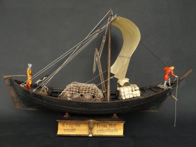

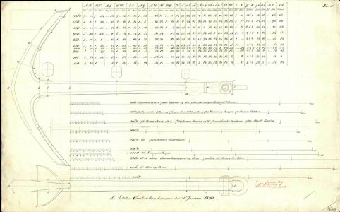

s as we see them today are truly old, approximately 1,900 years old. So having and anchor that appears modern on your cog is still on the mark. The anchorsuppplied with your model appears to be of appropriate size for the vessel.

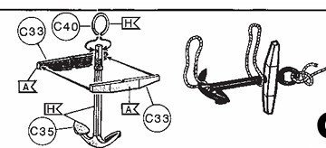

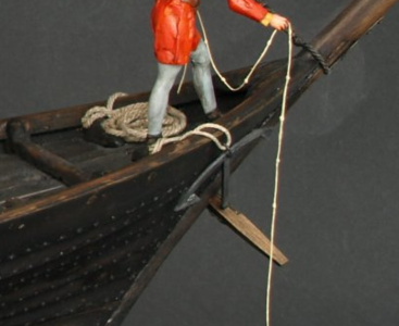

The ring for stowing it, yes. I believe the anchor line is passing over the port rail, under the bow and is still attached to the anchor stock - the line is just not visible in this view.Thanks all, I'll need to go with the kit supplied anchor, in the smaller Cog above, I note the ring is on the hook side,

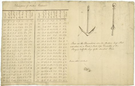

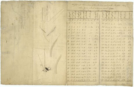

It may be somewhat dependent on nationality and era, as well as rate? For English ships of war there are details in the Public Records Office (PRO106/2508) , Brian Lavery's book The Arming and Fitting of English Ships of War, and David Steel depending on the era. Usually there were several sizes on each ship so once you have the weight of each anchor, the following chart might be helpful if the era is close.My questions would be:
How long is the anchor shaft?
What is the ratio of the proportions (anchor shaft, anchor head, cleat etc.)?
What is the diameter of the fastening ring?

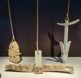

I hope this helps you. FrankThe anchor of ‘10 is from 1840 and is about the same type as included in the Heller kit (apart from the shackle that is the well known ring). It is also anachronistic for earlier buildds as the smiths in the old days had trouble to produce the curve in between Arm and shaft. Older anchors should have a sharp edge in between arm and shaft as in the second picture of #7. So imho the anchor provided is far too modern. But to be honest I do not know how it would have looked, probabely slimmer ...
Here a german article that at least shows the anchor stocks:
And the head of a Kogge-anchor
