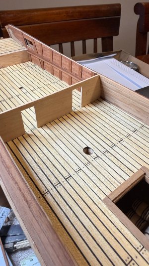

I'm starting on the cabins on the lower deck. Should the cabin walls be perpendicular to the deck or glued to follow the curvature of the hull?
The plans aren't clear.

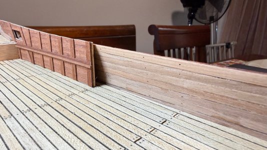

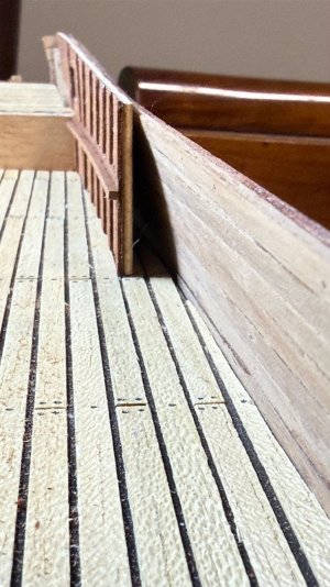

Here's a photo of the wall (pre-paneling) that shows the curvature.
I will try and get the wall in question as close to the shape of the curved hull as possible. But it may be an issue with the paneling already glued on.
