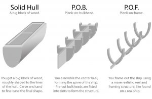

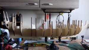

Also you can chosse a much simplier shi to build as Pob,there sre plenty of kit plans out there.

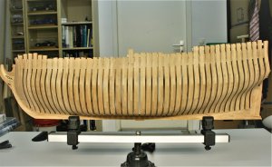

Pob is plank on bulkhead like most kits designed.Pof is plank on frame.,I need to get some images for reference to show you
Steve there is another option, it is what I like to call a SEMI-SCRATCH build CHECK THE LUMBER YARD SEMI KITS, for me the best one to learn by is THE LUMBERYARD CAUSTIC GREAT POF MODEL especially for your first scratch build, the instructions are on youtube, DAVE STEVENS(LUMBERYARD) IS A MEMBER HERE HE CAN GIVE YOU ALL THE INFORMATION THAT YOU NEED CHECK IT OUT. HOPE THIS HELPS Don
