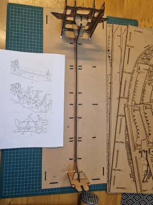

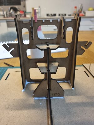

In the first step I completed the numbering of the parts in two boards out of the five components of the jig, not numbered. after that I started in the first phase of the jig building, I attaching a few pictures of the construction stages.IMG-20211206-WA0003.jpeg
20211206_205645.jpg20211206_210631.jpg20211206_210958.jpg20211206_212310.jpg20211206_213524.jpg20211206_221912.jpg

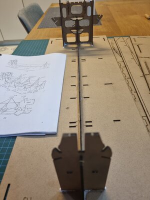

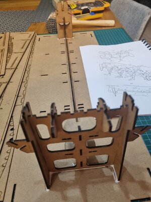

Today I continued to prepare the jig of the model according to the instructions and the drawings in the instruction booklet which are very clear. I stopped at this point to allow the glue to dry and the structure of the jig to crystallize / strengthen.
I attach pictures
20211209_190418.jpg20211209_190426.jpg20211209_190452.jpg20211209_190627.jpg20211209_191131.jpg20211209_190634.jpg20211209_194706.jpg20211209_202612.jpg20211209_202524.jpg20211209_202550.jpg
Dear Jim
According to the pictures above I probably glue those parts them. Unfortunately I missed the warning you did give on your blog. I would be happy to explain why they should not be pasted and also get advice on how to correct the mistake

If you use water-based glue (PVA), you should try loosening the joints with water. Just be careful to moist the parts, they are MDF and it doesn't like to be wet. Get the cotton swab and try moistening only the glue sim. Then use a very sharp blade and cut\pry the slots.
Those parts must be removable for later use when you will need to remove the hull from the berth for outside sanding and then put it back in to berth for internal work.
