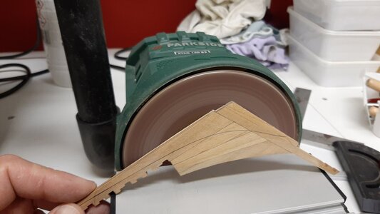

After scraping and sanding I start with the rabbet. For the stem this is a 45 deg angle of about 1 mm. I sand this on my disc sander at low rpm to have better control over it.

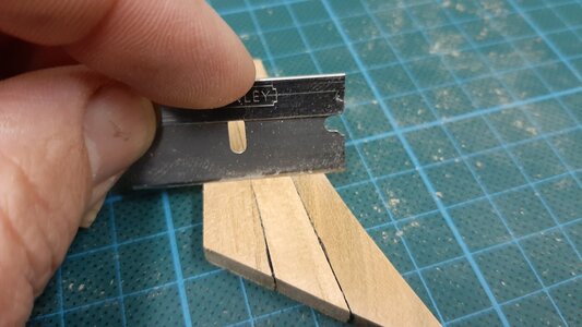

On the stern the angle is changing from 45 deg in the center to 0 deg at the stern. To create this I scrape the rabbet with a razor blade.
