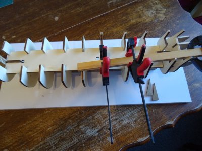

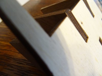

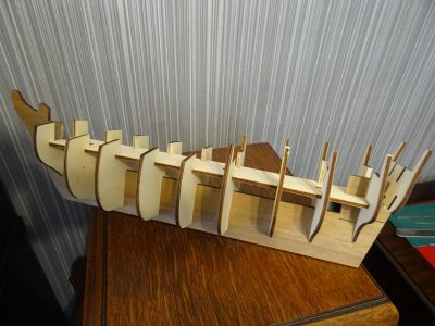

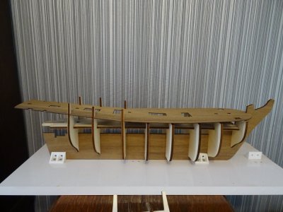

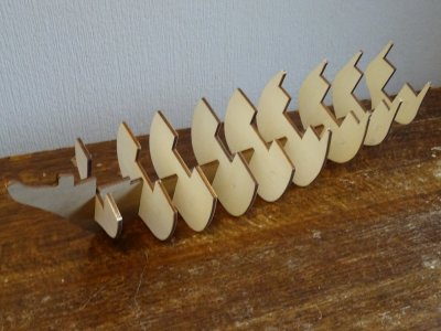

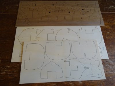

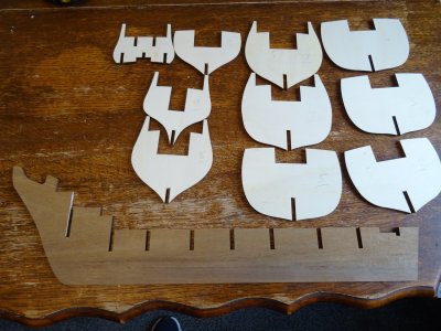

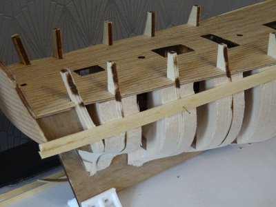

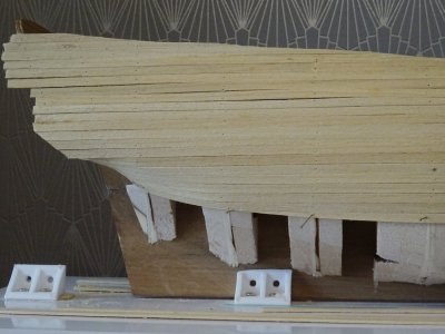

After removing the frames and keel the slots needed a lot of filling to make them fit so i am guessing they have swollen over the years

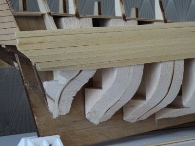

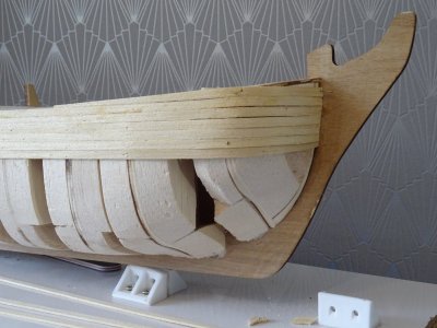

Whatever the case, at least you have the original plans from 1787 available to help you along if you want to at least compare the kit to the actual vessel. https://www.rmg.co.uk/collections/objects/search/Bounty plans With the very few bulkheads, filling between them with a soft wood will help the planking a lot.
Thanks Allen i will do that at the moment nothing glued just trying the parts and nothing seems to fit

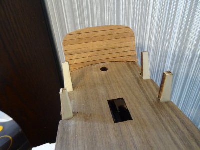

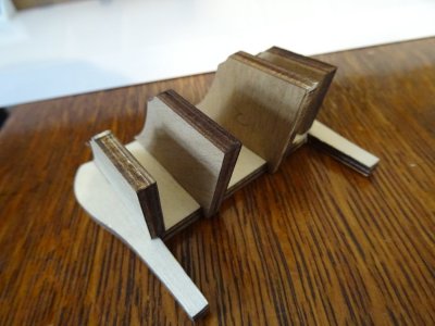

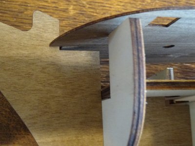

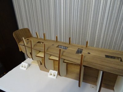

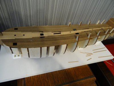

To get the deck to sit down to the keel i had to deepen the slot in the bulkhead by about 4mm and the stern cabin formers bear very little resemblance to the plans

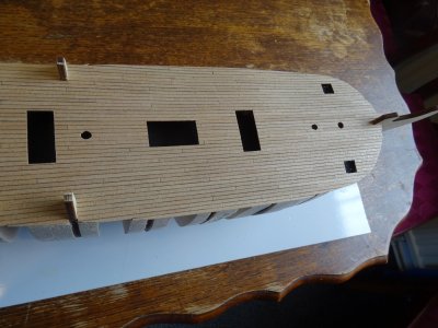

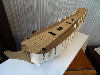

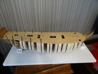

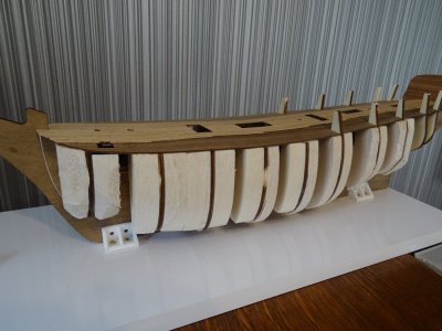

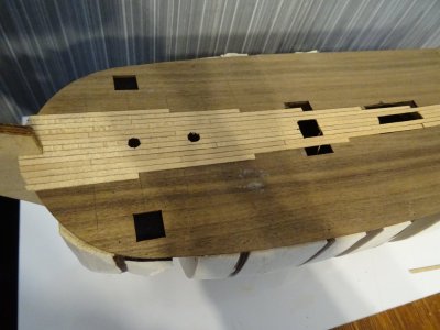

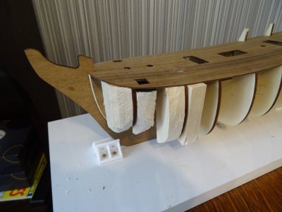

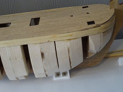

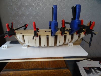

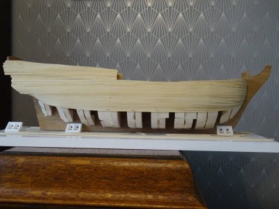

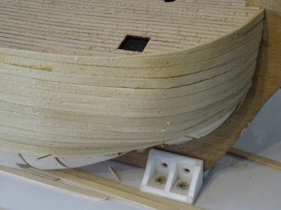

The frames and deck are now glued and starting to make fillers before planking

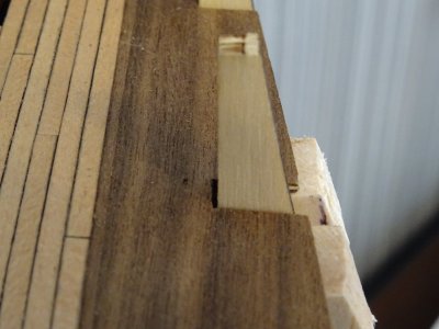

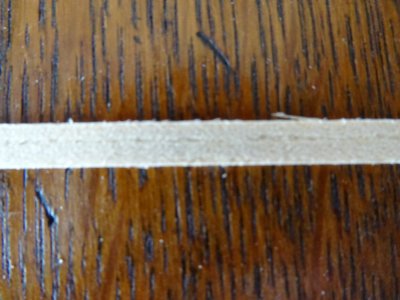

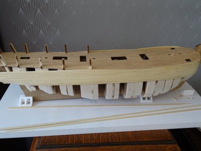

The instructions suggest planking the hull before the deck but i think i will do the deck first as it will be simpler to shape the planks by sanding them after gluing

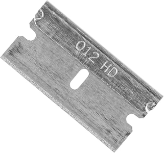

If you are speaking about smoothing the deck surface, you might like using a scraper instead of sandpaper, or at least before using the sandpaper. A stiff-backed razor does a great job.

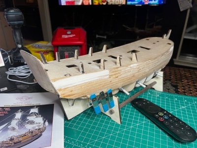

Hi Roger. I just joined the group recently and posted pictures in the intro section of this Sergal vintage kit. I bought it when I was 18 and cut most of the parts out and fit them together. I just actually built it the end of last year and I'll be 70 next month. It's my first ship build and I found it to be quite difficult, not because of the build, but the plans were awful to understand. You appear to have the build well in hand, but if you have any questions as you proceed don't hesitate to ask.
Hey Roger. This may not be the proper answer but when I built mine I sanded the deck to match the ribs and it worked out fine.
