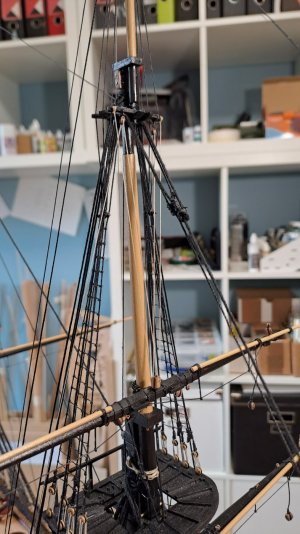

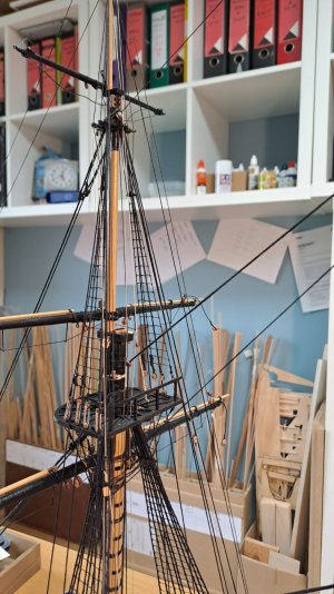

Your research is impressive and the results are a model that is really looking great! I hope Caldercraft is following your build and sends you a commission for finding and fixing their mistake.:):)
Your attention to detail continues to impress us. You have the main stay and main preventer stay on the starboard side of the foremast which is often missed. And the ties at the inboard end of the stunsail booms are rarely seen but you took the time to include them. KUDOS!!

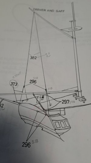

The rigging.
Note that I do not always follow Caldercraft's drawings.
Take for example the Vang Pendants section. According to Caldercraft's plan you should start from an eyebolt and then attach the rope via an Single block and the fall to an cleat in the side by the taffrail.
According to James Lees : the rigging I've choosen:
"Vang pendants were one length of rope, clove-hitched in the centre to the peak of the mizzen yard : a double block (usually a long-tackle block) spliced into each end which connected to a Single-block hooked to an eybolt in the quarter piece each side, the fall belaying to a cleat in the side by the taffrail".
