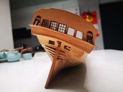

What is the red rectangle area that you show? It cannot be for the gun ports as the guns would have to be in the bread bins on the lower deck and the barrels would have to be five or six feet above the deck. Picture below shows the stern guns if they were on the upper deck or lower deck. I would go with contemporary information first as John Williams signed the drawings. Then again no one is infallible so maybe the original draftsman and/or designer of the ship made a mistake. The only evidence I can find so far that she had stern ports is from the 1777 Marshall painting which does not match the design drawings. Assuming she had stern ports these were typically not with guns. The aft most guns on that deck would be maneuvered to these ports. She carried twenty-four 9 pounder guns on the gun deck as can be seen in the notes on the drawing below and the number of gun ports on the side of the ship match that with 12 per side.

I guess there were no guns on the lower deck on the Enterprize 1774 - I count 12 gunports on each side on the "upper deck"

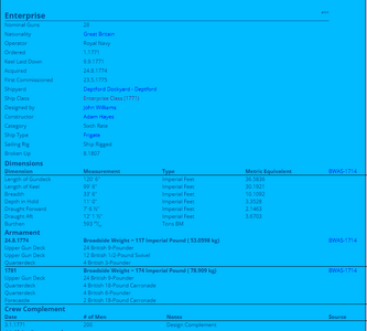

also according given informations f.e. threedecks (based on Rif Winfield)
I can not find fast a contemporary drawing showing these two ports at the stern only the painting
so close above the waterline I am pretty sure, that the lids were more or less permanantly closed to keep the water out
So, if there were these ports, than it can be only for ventilation of the closed lower deck, open only when laying in harbour on calm sea
Hi Karl,
I saw the Joseph Marshall paintings as well and it really caused confusion in my head. I personally would rely on the plans in post 60 above, . The series of paintings by Marshall are exceptional, but at least in this case, does not match the plans. Builder's choice :)

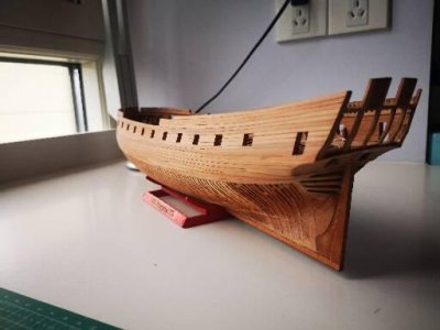

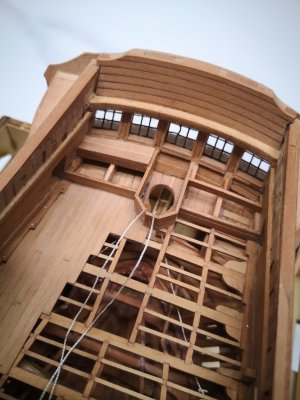

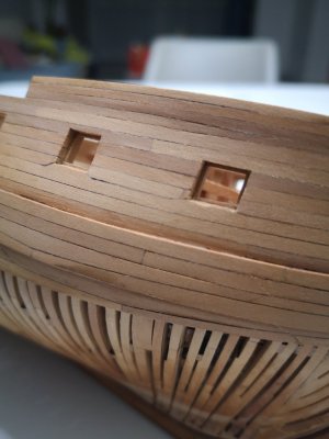

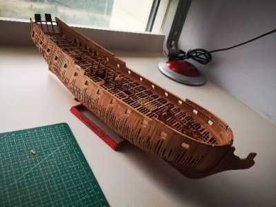

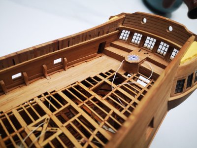

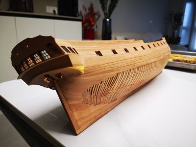

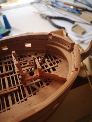

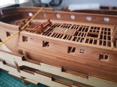

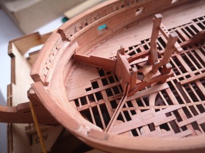

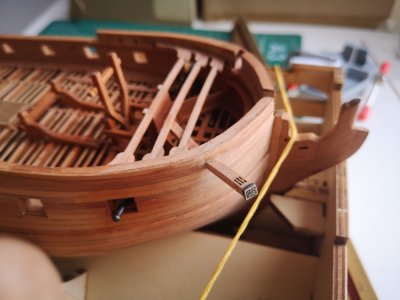

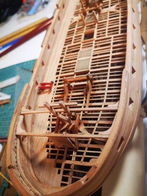

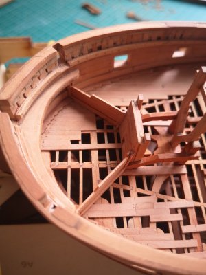

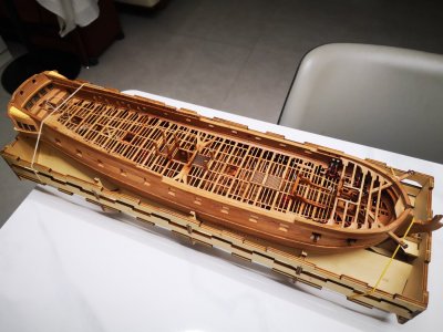

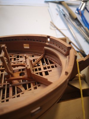

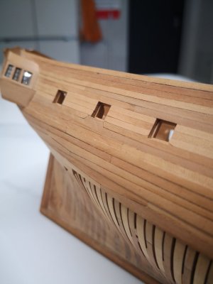

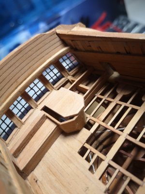

好久没更新了,并不是停工,因为小横梁重复的工作量太大,1*1mm的小横梁全部开槽安装,真的是快不起来,8月中旬全部炮甲板小横梁完成,开始做甲板压条,做内船壳,根据內船壳弧度调整炮窗高度
发现套材中编号W5的内船壳高度超出船舷3~4mm,是垫高船舷还是磨低船壳,这个要跟设计师确认一下,自己感觉应该是垫高船舷,后期也好修改
September 12, 2024
It’s been a while since I’ve updated. It’s not a work stoppage, because the repetitive workload of the small beams is too big. All the 1*1mm small beams are slotted and installed. It really can’t be done quickly. In mid-August, all the small beams of the gun deck will be completed, and the deck construction will begin. Layering strips are used to make the inner hull, and the height of the gun window is adjusted according to the curvature of the inner hull.
I found that the height of the inner hull numbered W5 in the kit exceeds the ship side by 3~4mm. Should I raise the ship side or lower the hull? I need to confirm this with the designer. I feel that it should be to raise the ship side. It can be modified later.

I love how you went into the detail of making the spirketting thicker than the quick stuff above it. Very nicely done!

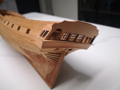

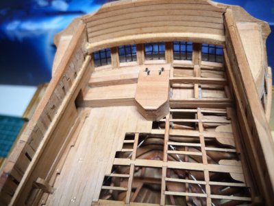

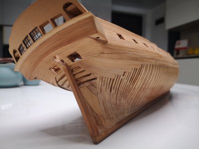

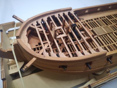

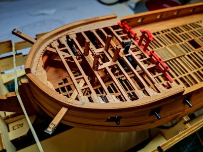

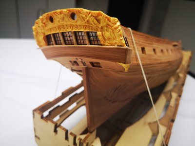

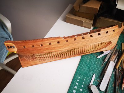

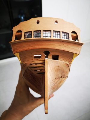

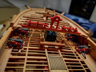

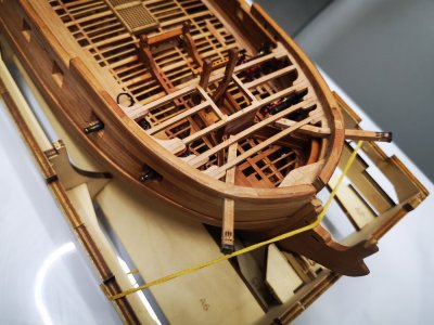

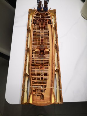

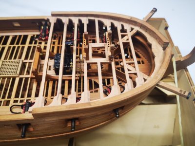

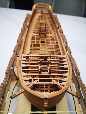

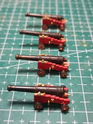

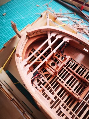

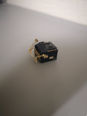

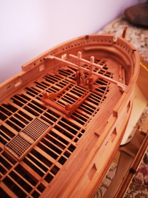

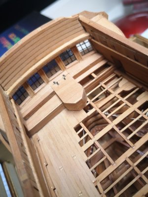

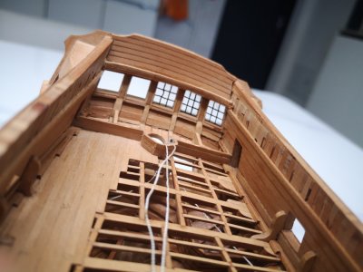

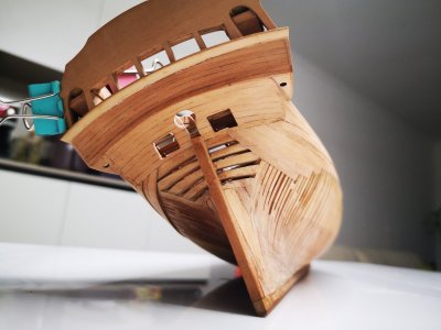

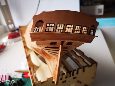

20250612更新:广州最近天气太热,好久没动手了,把前段时间做好的发几张,船壳粘了一边,尾部打印件太脆了,船尾雕刻粘的时候没对齐,拆分时搞断了,上色遮盖。完成了船头横梁,局部铺甲板,套材船头1/4甲板第1条横梁间距太大,考虑是否需要加多一条,安装吊锚架,有蚀刻片装饰,完成锚仓,隔板做成可活动的安装锅炉,船钟支架,火炮
Hey Uwek,
really very nice and the scale is awesome.

Günther Ship-1
Stunning.
