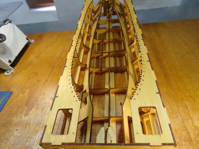

Hi All.
A few photos showing the building cradle (or jig) in it's now complete form. It's been fun putting together this little project. The plywood is excellent quality and everything fits together perfectly to make a good strong construction to build the hull ribs in. As I've done in the past, l have given the whole thing a coat of tung oil. Not a specified step in the construction, but as the hull will be in this quite some time and temperatures and humidity change drastically here in southern Spain from winter/spring to dry, very hot summers, there is always the risk of the plywood construction warping or twisting slightly. I am taking no chances. It also looks nice as well I think
That's a very nice jig! Unfortunately, tung oil (or any kind of oil, for that matter) will not prevent and barely even slows down moisture ingress/egress from the wood. Only an actual film finish would do that. Epoxy would be the absolute best, and marine varnish is a close second, but even that lets some moisture through. Nevertheless, the oil does make it look pretty. :)

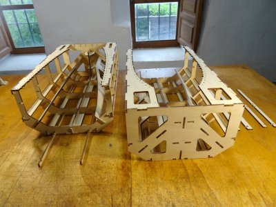

New kit, new log. The long awaited new kit from Modelship Dockyard, HMS ENTERPRISE in 1:48 scale.
The kit arrived safe and sound and in perfect condition. Thank you Victor and DHL for a great service. Zoly has already done a superb unboxing. I can´t match it so I´ll skip that part, just to say the package was very well packed and all the parts and materials look to be amazing. This is going to be one hell of a build. The finished model is huge with a hull length of 960 mm and will take up a lot of the available space on my work bench. I have started at the beginning, obviously, with the building of the cradle that positions and protects the keel and ribs during the construction process. It looks to be quite a complicated affair, differing in design from other kits I have made so far. It is made from good quality 5 mm plywood, laser cut. The parts fit together very tightly so a little sanding of the cutouts to remove the laser char and achieve a perfect fit is essential. The pictures show parts and make up of the first stage of construction which is in 2 halves that have to be joined together due to the length. Also the parts for the second stage are shown in the last 2 photos.
It does look nice though doesn't it
