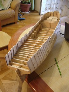

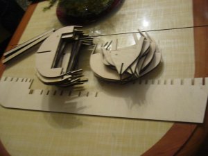

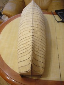

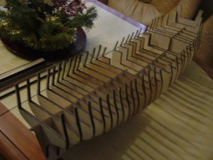

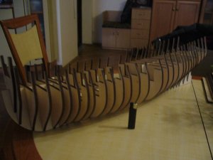

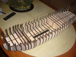

Scratch ,use of paper shipyard plans I guess.This is a great ship to build. What kit is that ?
I agree with you completely - I will follow with big interestIt will be an interesting build.

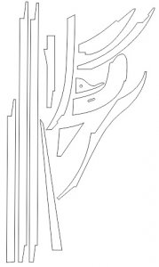

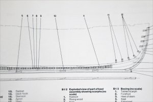

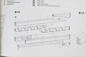

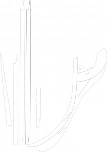

Here Christian is correct! Most of the british ships had the scarph vertical in the keel - different to the keelson.@piter56
the scarphs at the keel have an other direction by English ships. This form I only know from French shipy.

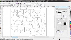

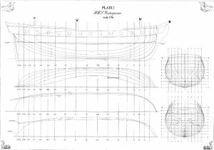

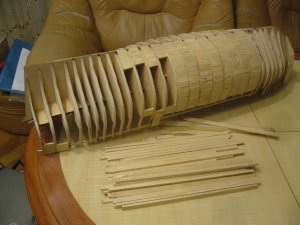

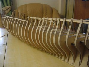

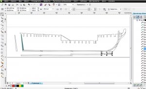

I have a drawing in electronic form, i import it into the program and modify it.Watching this one. are you drawing the frames up from the Plate 1 drawing or scanning in from the parts on the sheets then importing to the program to modify?
