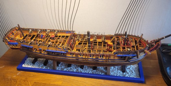

whatever you decide, I'm sure it will look great like the rest of your work !

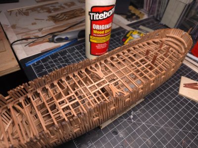

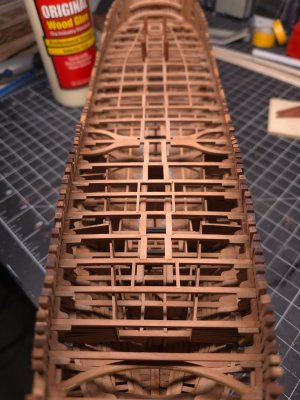

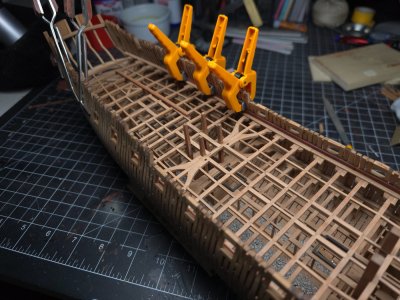

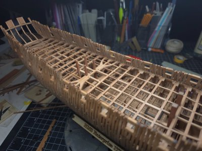

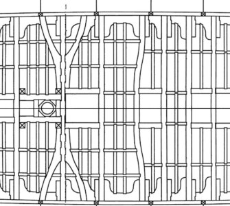

Made some changes to the gun deck to be more inline with the plates for Enterprise.

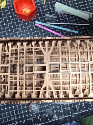

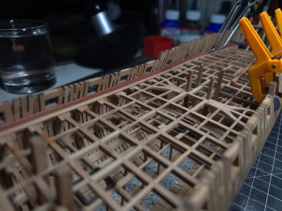

The waterway is exactly correct, it has too many cuts in it and it needs to be shaped. For example the left side is revised and the is the original piece.
At this scale the hull side of the waterway should be 1.5mm but the inner side should be 1 mm, because planks at this scale should be 1 mm. It should look roughly like this. The outer .5 mm should be flat because the wall planking.
Edited version.

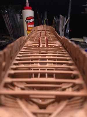

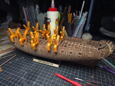

Dry fitting

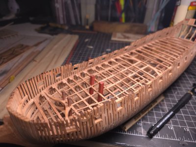

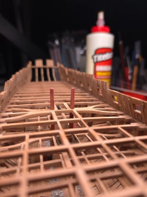

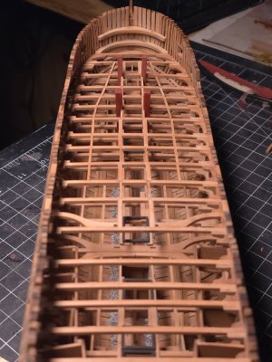

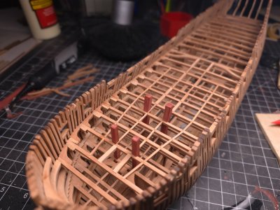

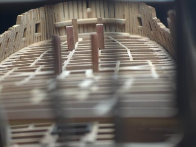

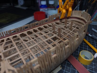

Some changes. So the design of the gun deck is incorrect, and I decided to fix it so that I can properly install the forward mast. Also decided to take out the red beams because I don't like the finish on them and they are too thin.
So here is the before, with bloodwood.
Now the bloodwood cmpared to the new redheart that I would be using for the next set of posts shows a stark difference.

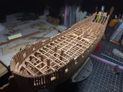

Here is the corrected design and new posts.
Much better I think.

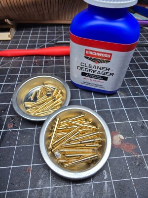

While the glue dries decided to start work on cleaning and blackening the cannons.
This is after three washes with the brass black and two shines with the wax. Seems like it could be darker. I used cotton swabs and a microfiber towel. I've seen others just drop them into a bowl and let them soak, maybe that's the better approach.

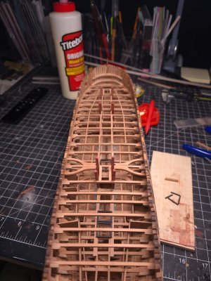

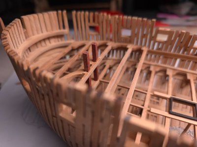

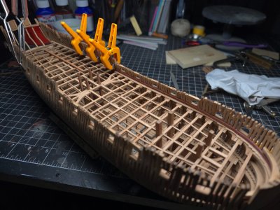

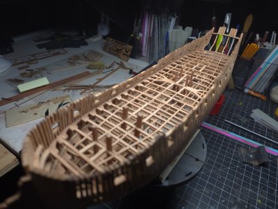

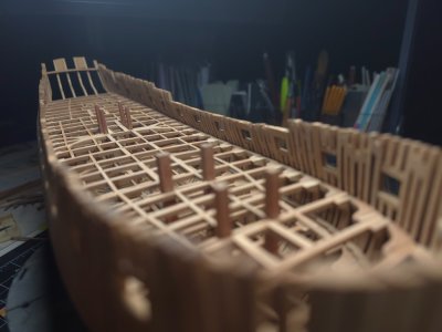

I used the pre supplied pieces as templates for cutting replacements out of redheart. Working up the sidewalls now.

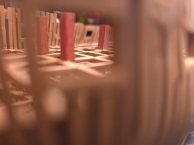

I'm not really sure what happened to the installed pieces of redheart. They seemed to have lost all their color, I thought maybe they dried out but the red heart I'm using for the sidewalls now was cut at the same time as the posts and has been sitting next to the boat. I'm being careful not handle the redheart without gloves, thinking maybe the post absorbed the oils from my fingers maybe.
I'm considering taking the posts out, if I can, and replacing them with new pieces so that it all matches.
