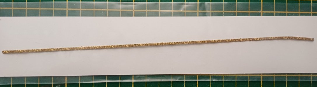

Hi Robert, you are most welcome, I am glad to hear that I have been of some help given that I have received so much help from this forum myself. Part 288 was a mystery to me as well. It arrived in the kit wrapped in a plastic sleeve like this:
It is quite a solid piece of metal and it didn't make much sense to try and massage it into the shape required for the Eking Rail, which is why I opted for a wooden replacement that, even for me, was not that difficult to manufacture :)

Hi Nomad, kind of you to post the picture. I simply cannot find it - either it got forgotten at Amati's or I have unknowingly lost it. Never mind, with your images it seems to be possible even for me.

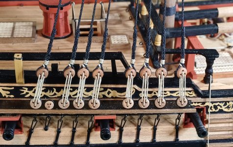

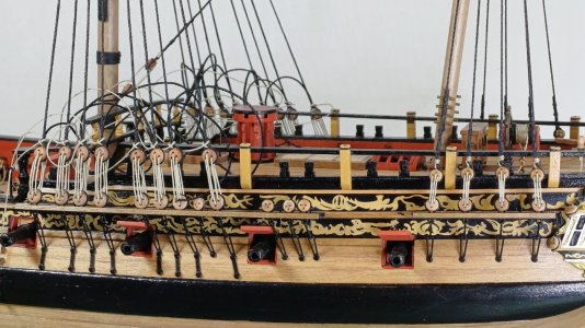

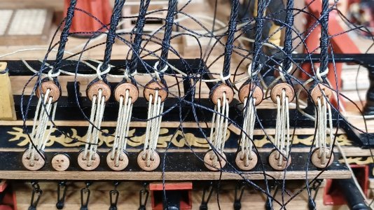

The construction of the Main shrouds is much like that of the Mizzen shrouds, only there is more of them and everything is a little bit bigger, such as the diameter of the deadeyes, shroud ropes and lanyards, as well as the gap between the upper and lower sets of deadeyes.
I used a similar spacing jig I'd used for the Mizzen shrouds to keep the deadeyes equidistant, and the lanyards are only tied off at the very end to adjust the shroud tension on either side of the Main mast. Seems the trick is to try and achieve a consistent tension across all the shroud lines without disturbing the symmetry of the rows of deadeyes. Like trying to sneeze without blinking.
The disarray of ropes and lines give the impression of deadeyes throwing a wild party at home (above) .... until the parents walk in (below) ROTF

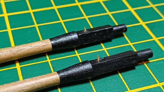

Before progressing with the stays and foremast shrouds, the spare topmasts are temporarily installed across the tops of the gallows and forecastle rails. Small brass pins are used to secure the masts in place, which allows for easy removal if they get in the way of the rigging later on.
The spare topmasts will eventually be lashed together and serve as a support for the ship's boat, which will in turn be lashed to the masts to hold it in place.

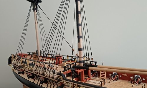

With each new rigging rope added to the ship comes a new snag point as well. With my hands working quicker than my brain I feel I sometimes need to work in slow motion to try and avoid the frustration of destroying a painstaking piece of work by a single and irresponsible hand movement :confused:

Beautiful work Mark. I don't know what it is with rapid hand movements in and around delicate ship parts, I have the same problem on occasion.

That is really nice rigging, Mark. A pleasure for the eyes. :)

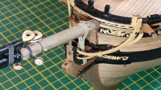

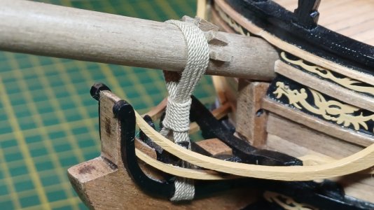

The bowsprit is installed at this point in anticipation of the rigging to come. All the bowsprit hardware was prepared earlier, so it remained only to house the bowsprit at the stem and apply gammoning to lash it securely into place.
It took several attempts to learn a gammoning technique that hid the knots from the naked eye. I also read somewhere that the number of vertical lashings over the spar should match the number of horizontal wraps around the middle. Mine were 7 and 8 respectively, so close enough :p

Good morning Mark. Wow my friend those dead eyes, lanyards and knots/whippings are fabulous. Cheers Grant

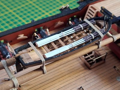

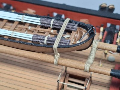

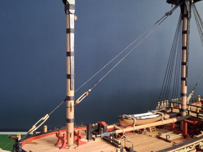

The spare topmasts suspended across the waist are lashed together to serve as a support for the ship's boat, which in turn is lashed to the masts to hold it in place. I like using the word 'lashed' :p
With the boat secured, work can continue with the main and preventer stays overhead.

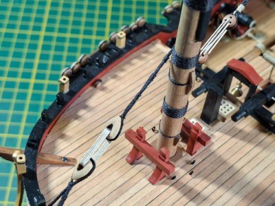

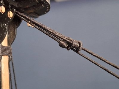

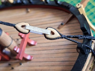

The mainstay and preventer stay extend from the main masthead towards the bow of the ship and are secured to the bowsprit and foremast respectively. Like the mizzen stay, the mainstay and preventer stay are served, loop around the main mast just above the shroud loops, and are held in place by a mouse.
At the other end, the preventer stay is secured to the foremast by a pair of deadeyes and the mainstay is attached to a collar looped around the bowsprit.
The mainstay collar is connected to the mainstay rope using heart blocks lashed together with .5 mm rope. There's that word 'lashed' again :)
The end result is a preventer stay that sits slightly lower than the mainstay, and a mainstay that passes very, very close to the foremast on its way to the bowsprit. I rigged both stays with as much tension as my conscience would allow to prevent any 'sag' when a hoist for the ship's boat is rigged to the preventer stay later on.
