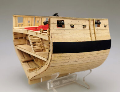

Beginning with this year we were already able to see the highly interesting kit of the Granado section model
and since some months we were able to follow the development of this amazing kit in one of our topics
-> so we all want now to see the final content of the finished kit, which I recieved short time ago

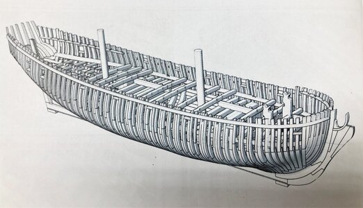

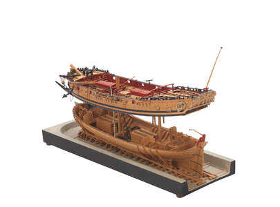

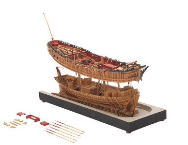

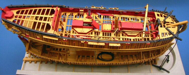

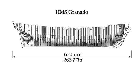

The size of the CAF model in scale 1:48 when finished completely masted and rigged
at the end, with all three parts the kit, the model will have approximately the content like the well known model at the NMM
and the great add on on this model will be the possibility, that the modeler can also separate the hull in a similar way like the above shown model.
The frames are prepared in such a way, that the upper part can me separated from the lower part

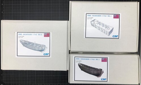

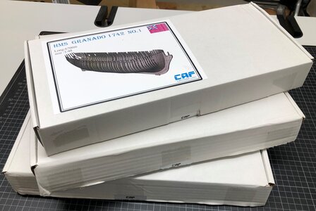

Package
The kit comes safe and careful packed in one covering box, wrapped completely with adhesive tape - so definitely no damage can happen and also no moisture can enter during the very short transport time (my box took only 5 days from China to Austria)
Inside the cover box we can find 3 sealed cardboard boxes - 2 boxes for session 1 and 1 box for session 2
So let us take a look inside ..... it is like christmas, when you are allowed to open the boxes .....

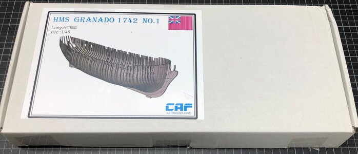

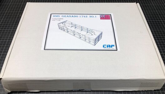

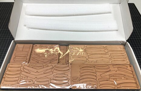

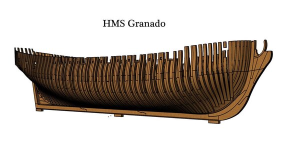

Box 1 of Session 1 - Content
On the label we can see a 3-D animation of the finished framed hull
Inside we find extra sealed and with folio wrapped the wooden sheets with laser cut elements

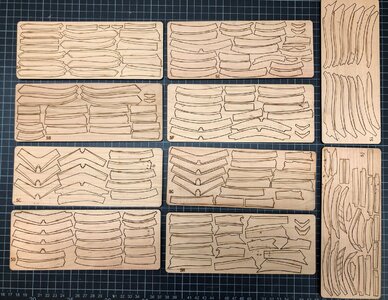

a first overview of the wooden sheets

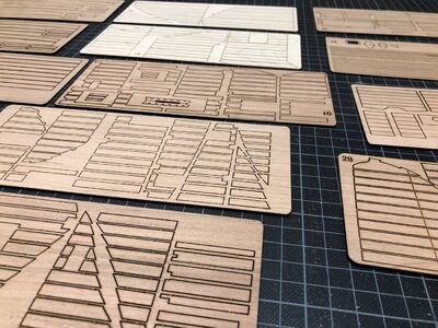

Now let us take a closer look at the different types

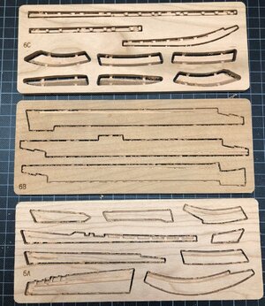

Here first the sheets with 3D-CNC cuts - very accurate prepared

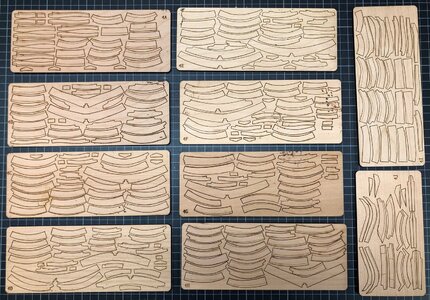

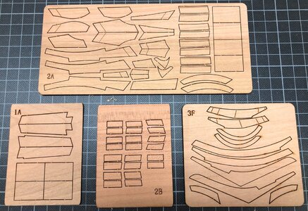

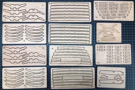

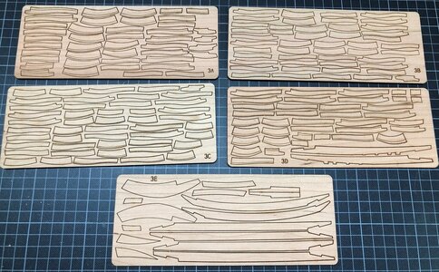

The laser cut sheets

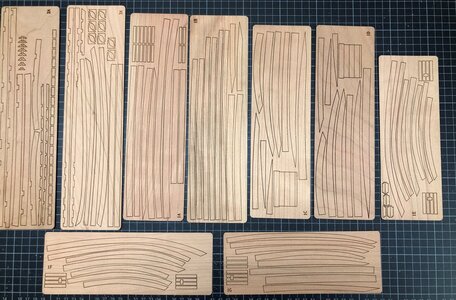

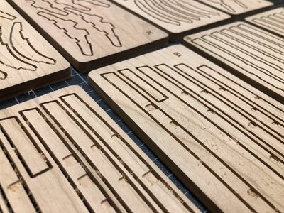

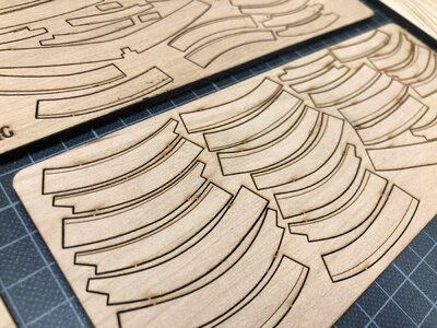

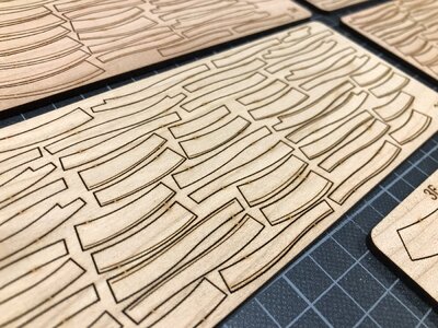

and now we come to the frame elements - shown in groups according the thickness of the timber - here sheet typ "3"
a close up showing the very fine and accurate laser cuts - also the beveling lines are marked with the laser
the sheets type "4" have a different thickness
and the sheets of type "5" - once more with a different thickness
We can recognize, that the quality of the timber is very high - very fine grain, no colour differences in the same sheet / same element, no knotholes or other damages inside the wood and every cuts are made with a very fine laser
All together we are getting within the first box appr. 14cm of timber sheets

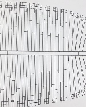

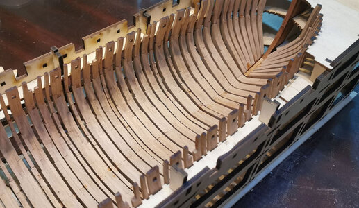

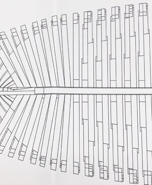

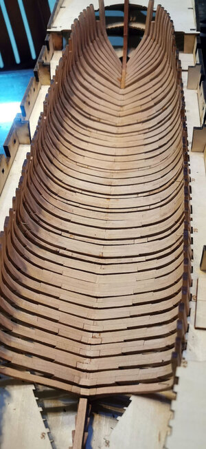

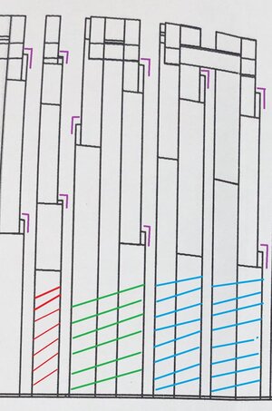

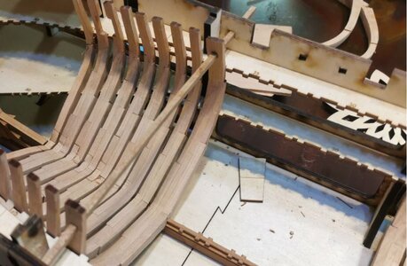

One very special detail of this kit is the fact, that the hull framing is build by single, double and even triple frames
Here a short excerpt of the top view drawing with the finished frames
you can see at this area of the hull from left to right a single frame (red), a triple frame (green) and two double frames (blue)
and you can see the steps (parked with purple) where the width of the individual frames is reduced (from floor timber via the futtocks to the top timbers) - see also the already mentioned different types of width of the sheets
Here some interesting photos of the CAF- model

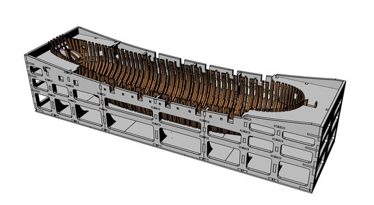

Box 2 of Session 1 - Content
On the label we can see a 3-D animation of the jig

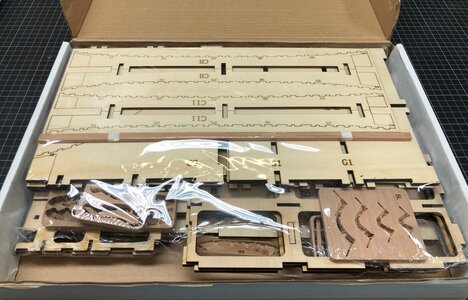

Inside we find extra sealed and with folio wrapped the wooden sheets with laser cut elements and on top a sealed bag with drawings

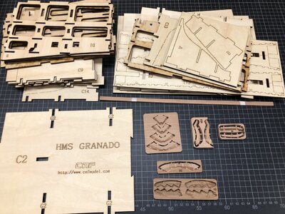

Overview of the wooden parts

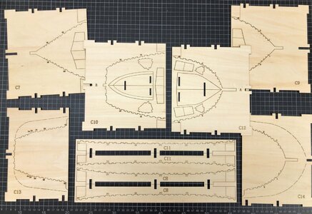

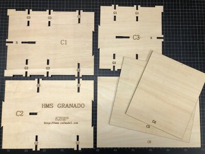

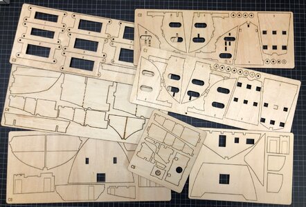

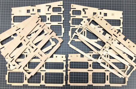

Let us take a closer look at the plywood elements of the jig - all parts made out of high quality plywood
The jig looks like a small project inside the project - at the end it will look like this animation shows

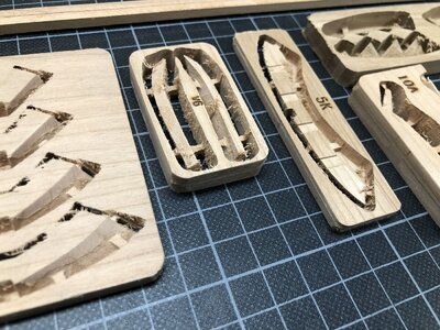

In addition we can find in this box some smaller CNC - prepared elements

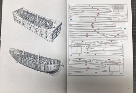

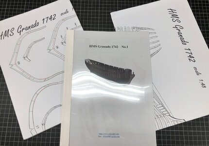

Manual and Drawings of Session 1

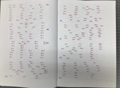

The Manual
First of all let us take a look at the Manual. A lot of pages with animated colored sketches and english text, showing in detail the principles and also details of how the keel and the frames have to be installed - easy to understand
and very helpful the CAF-typical content list of the different wooden sheets marking every individual element and part - no part numbers are printed on the parts -> the modeler has to find them via these sketches in the manual - I like this way very much
On the web-page from CAF you can find additional examples (in better quality than my photos) of the manual - take a look under "INSTRUCTIONS"

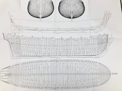

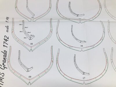

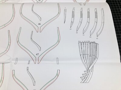

The Drawings
On one bigger drawing sheet you can find the frame drawing of every individual frame - showing also the beveling lines in red and green colors
On another sheet we can find all necessary information about the keel and the location of every frame in a longitudinal cross section and also top view.
All drawings and details are shown in 1:1 like the model
Some closer look
I feel confident, that all necessary information to build keel and the frame work are given in the manual and the drawings

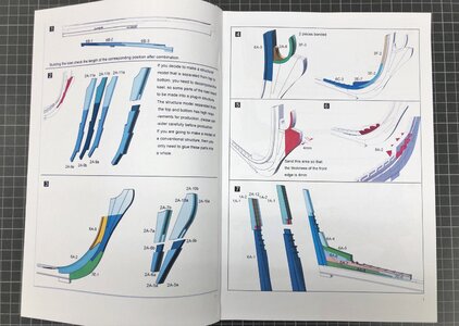

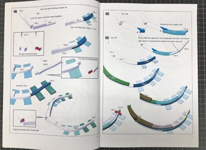

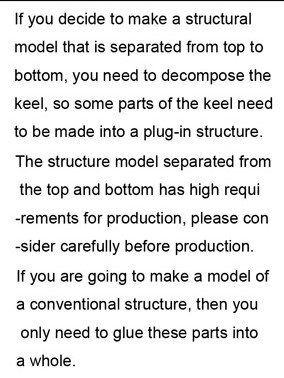

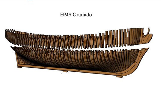

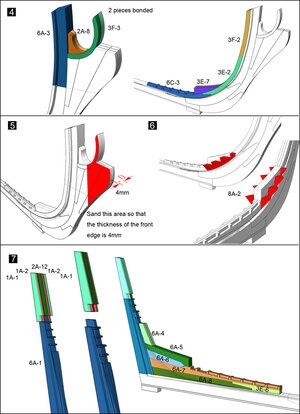

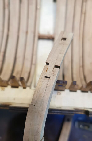

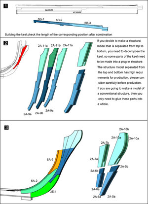

There is another very special possibility the kit is presenting to the modeler. The modeler can decide, if he wants to separate the upper from the lower part of the hull, somehow like the already shown model of the NMM. It will be up to the individual decision by each modeler to try to mkae this or also not.
A cut appr. in the height of the waterline, so that the interior elements are better visible
But the idea by CAF is not only to make a horizontal clean cut, but to devide all frames the top timbers from the futtocks

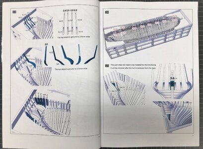

Here some excerpts of the manual where some examples are shown
But this should be considered very well, especially when I read the words by CAF
It will be a challenge, but definitely it will look great

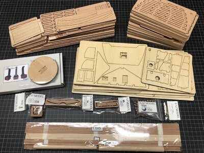

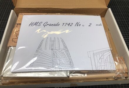

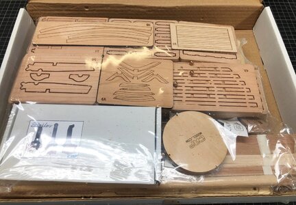

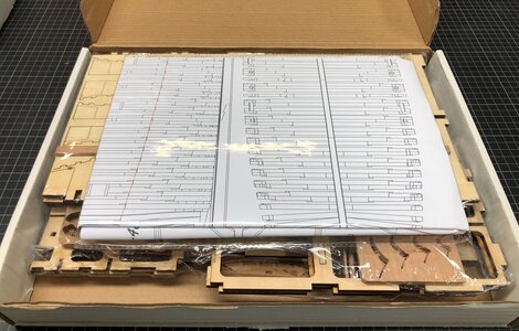

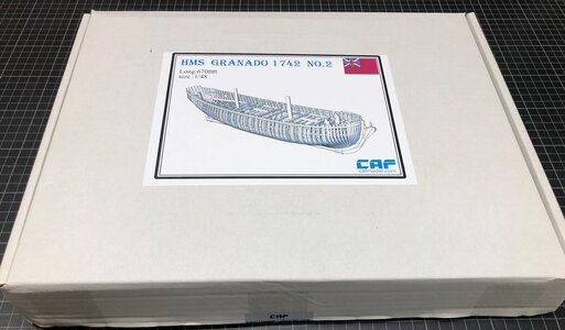

Box of Session 2 - Content
On the label we can see a 3-D animation of the POF-hull with the interior works
on top a bag with some more drawings and the second manual
once more as usual everything inside is wrapped in folio to avoid moisture
and the overview of the complete content
high quality laser cut plywood for the templates necessary for the interior works

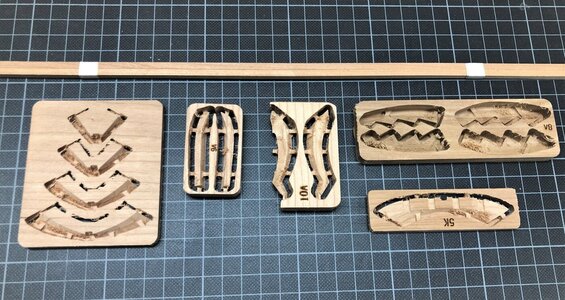

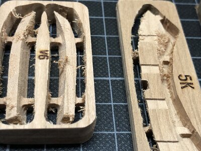

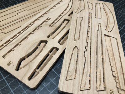

here you can see the CNC-prepared sheets with f.e. deck beams (incl notches for the carlings)
close up photo - also here very accurate milling works on very good quality timber

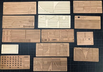

laser cut sheets with thick stuff and other inner planking
mainly interior floors (decks), walls and bulkheads
I could not find any flaws - very accurate prepared

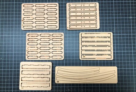

some other smaller CNC prepared sheets

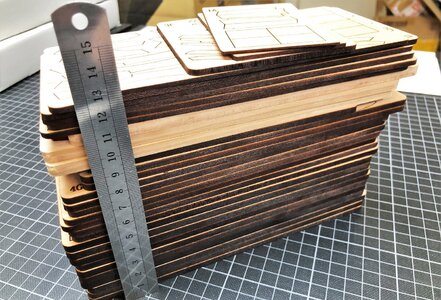

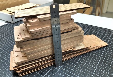

with this box you are getting once more 15cm of timber sheets in different thicknesses

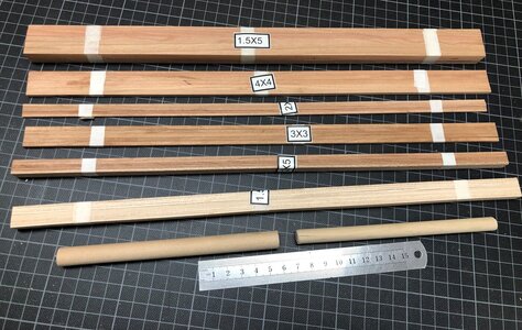

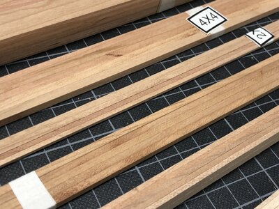

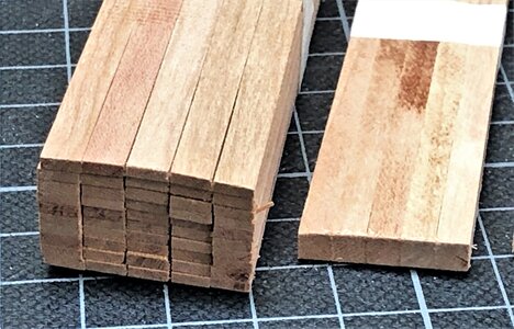

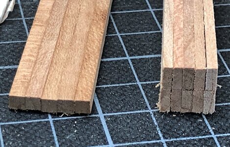

The wooden strips and dowels of the kit
very good quality, accurate sawn

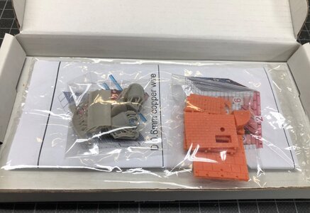

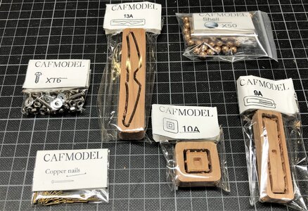

and also some small bags with nails, mortar balls and some smaller cnc-cut parts

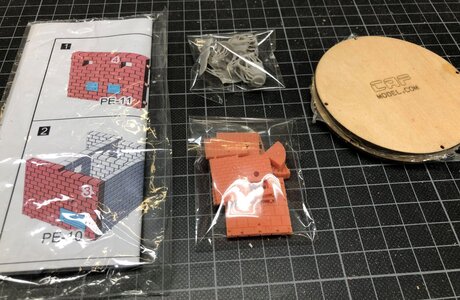

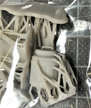

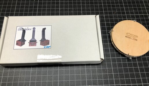

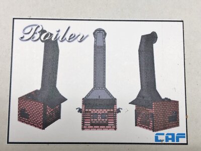

The oven is part of the kit, but good to know, that you can order this one (and another) separatly from CAF - maybe also interesting for other projects

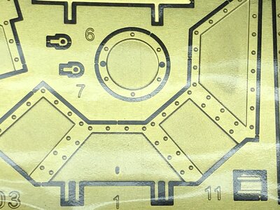

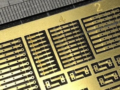

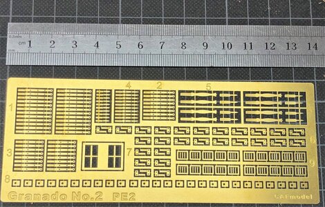

Also incuded in the kit is one Photo etched brass sheet with some hinches

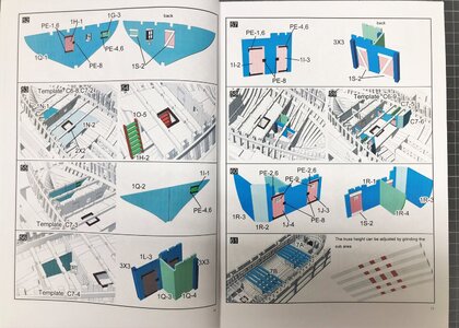

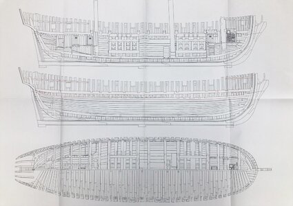

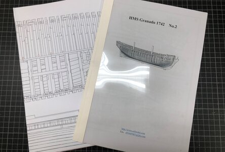

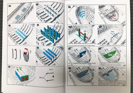

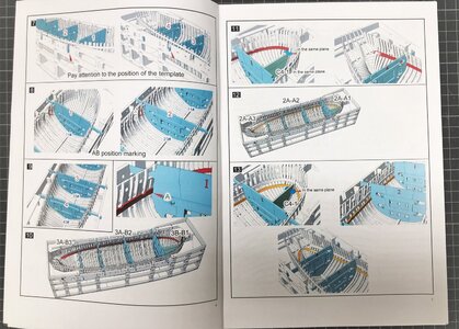

And the last contents of the session 2 are the second manual and the drawing
The manual is organized in the same way like in the session 1
and the drawing

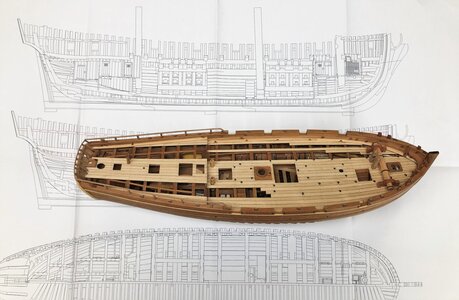

In order to compare the size of the new kit of the Granado with my known Le Coureur
