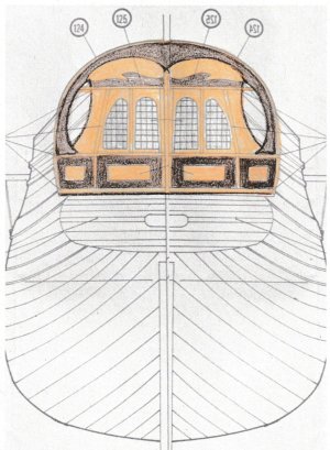

- I built the stern completely differently.

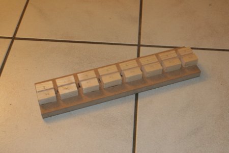

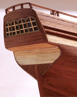

GRIMSBY by Bueno - Phase 1 - 01.jpgGRIMSBY by Bueno - Phase 1 - 01b.jpg#01 - 11/30/2013

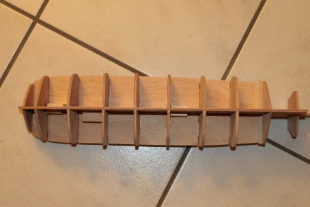

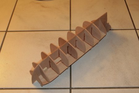

Since the plywood keel was completely bent, I first built a simple jig with gaps for the bulkheads.
GRIMSBY by Bueno - Phase 1 - 02a.jpgGRIMSBY by Bueno - Phase 1 - 02b.jpg#02 - 11/30/2013
The basic structure is complete.

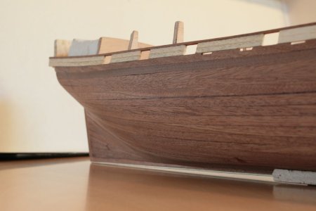

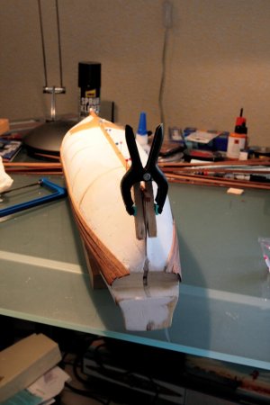

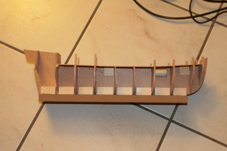

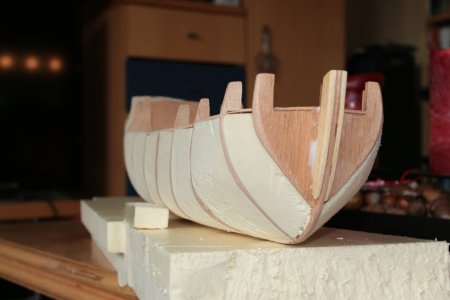

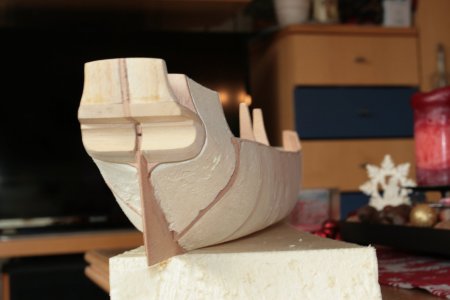

GRIMSBY by Bueno - Phase 1 - 03a.jpgGRIMSBY by Bueno - Phase 1 - 03b.jpgGRIMSBY by Bueno - Phase 1 - 04a.jpg#03 - 12/08/2013
I used Styrodur to close the gaps. especially because the hull is only single planked.
While filing, I noticed that a bulkhead in the rear area was too wide, resulting in an ugly kink.
Bulkhead #7 and #8 were probably swapped. I don't know for sure, though. In any case, it was relatively time-consuming to remove the kink.

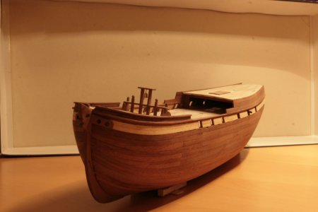

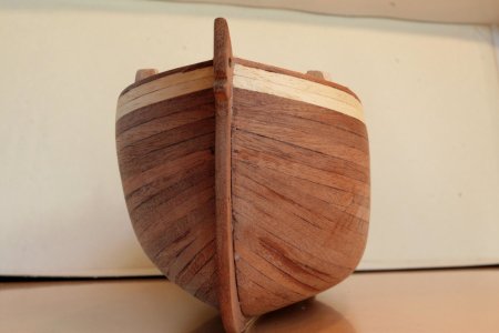

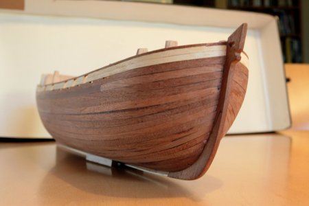

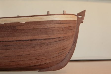

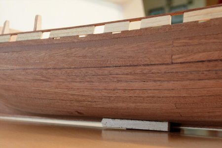

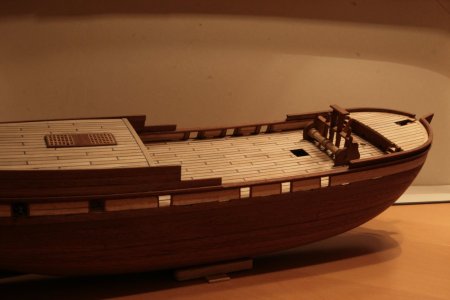

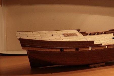

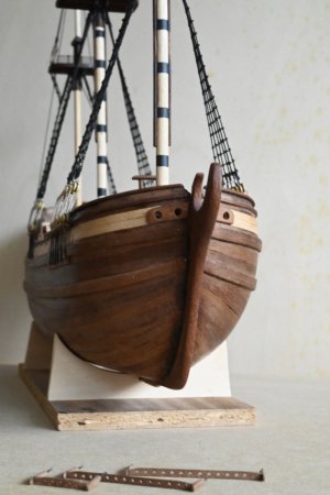

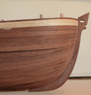

#04 - 01/12/2014

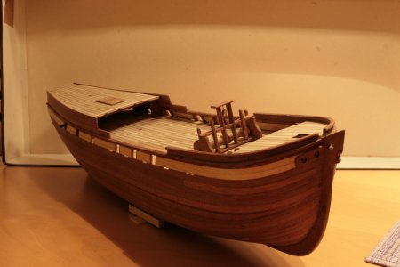

The (single layer) planking was a real challenge. The strips are made of 2mm thick sapeli and are somewhat brittle. The steam iron was my best friend during that time.

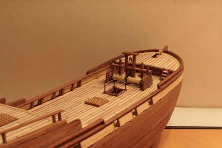

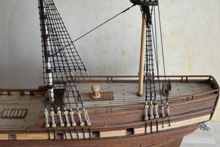

#05 - 02/26/2014

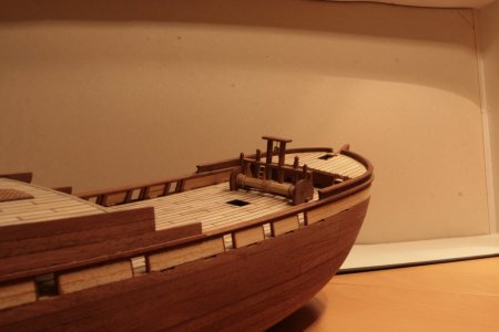

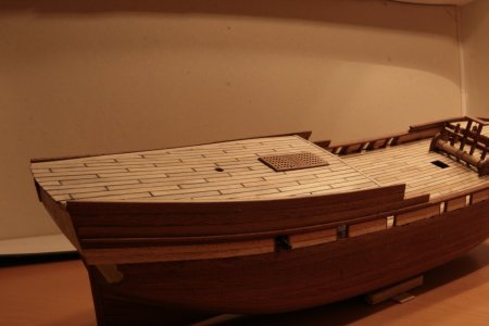

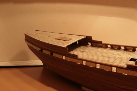

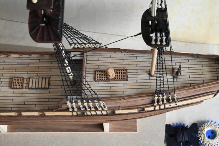

Deck planking is ready.
First, I used the strips included in the kit. They were very thin and I didn't like the color. However I didn't like the result. So I installed lime wood strips on top.
The anchor winch is already installed in these photos.

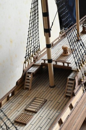

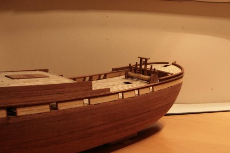

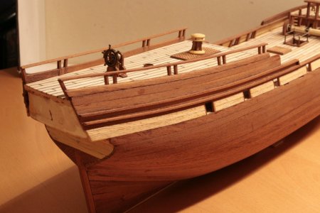

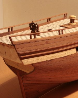

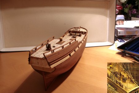

GRIMSBY by Bueno - Phase 1 - 06a.jpg#06 - 03/23/2014
Added further details.
This picture shows the first modification compared to the kit. It concerns the railing on the quarter deck. I made it from wood instead of brass, for historical accuracy. See also small image.
