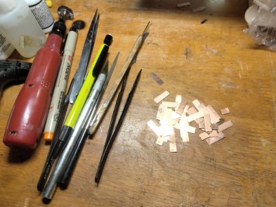

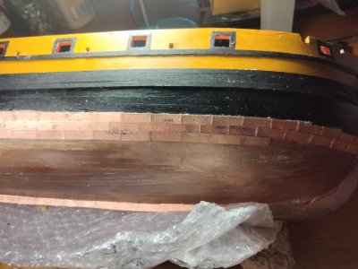

I did get another 10 copper plates installed but that was is so far for the day.
I got absolutely nothing done for a week after my last post of six plates. Hope this goes away soon. I've basically lost interest. I'm thinking that if I started my Sopwith Camel kit it might perk my interest

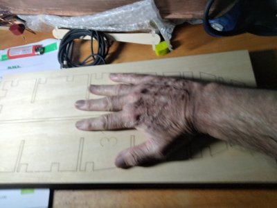

Did an initial plan review. Less detailed than I had hoped for but it seems like enough information is there to get the job done.
This is going to be a huge model. I'm six foot two and the deck is bigger than my spread fingers.
I'm looking forward to many, many hours of enjoyment. I anticipate some hours of frustration but usually it's due to me making a mistake.
This being my fifth build, counting the tiny model expo beginner kits, I already know it all works out in the end.17602001393788211601882663130221.jpg
This being my fifth build, counting the tiny model expo beginner kits, I already know it all works out in the end.View attachment 549528

This is real work. The frames are 5mm and the laser cut is too thin to fit my little saw blade and xacto knife.
