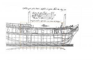

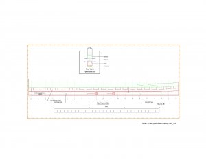

This project is based on the Original drawing and details from the book Legend of the Lake. Zoltan suggested this area for cross section as shown in the first photo
The model will be a navel board style with stub masts and exposed framing to show internal details.
When I made some preliminary layouts of the area of the Ontario to be modeled. I had a problem understanding the original draughtsman numbering system for his station lines, I renumbered them in a conventional format for the model.
The section will have 21 double frames.
Model Dimensions
Length: 16.25”
Width: 11”
Height: 12”

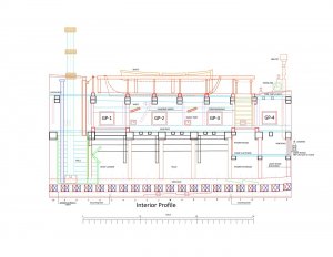

Drawings: The drawings will be made available from SOS when the model is finished.

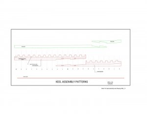

Keel Assembly:

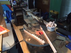

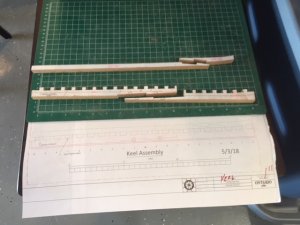

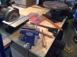

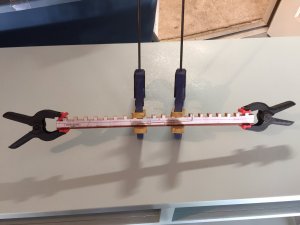

The keel assembly is made from European beechwood, I used a scroll saw to cut out the pieces and hand files to finish the notches and joints along with the keelson. This is some progress photos.

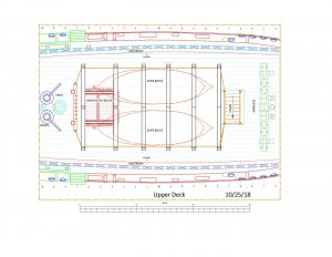

Hi everyone,
This build log is a prototype for a swell new group build and the plans will be sold by SOS to help with maintence cost. The drawings are not finished a lot of details still need to be added and they will be updated to reflect changes to the prototype. The original drawing did not show any internal details and John McKay’s drawings do represent ships of her class, but are not as built, the framing did not agree with what is written in the book and there are some small changes made to the prototype to enhance its appearance. If anyone would like to deviate from the plan set, feel free to do so. I am leaving almost all the planking off the decks on the port side of the model to show framing and details on the lower decks. Feel free to ask questions anytime I have all the answers and some of them will be right! My fellow members will help with the ones that are less than perfect, if we are having fun it is all good.
Mike
Hi Uwe, I will try to show the process of developing drawings for the various parts of the model. I am not a technical writer, but I will do the best I can.
